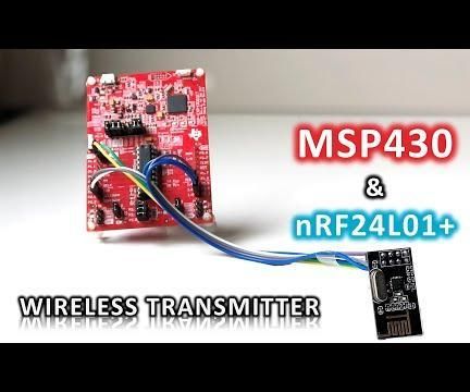

In this Instructable, we'll see how to make a Two-Wheel RC Car by using MSP430 & nrf24l01+ on the transmitter (Controller) side and Arduino Nano and nrf24l01+ on the receiver (RC Car) side.
In the controller side we'll use a two-axis analog joystick & 2 potentiometers to control the movement on the RC Car.

Now let's see the connections of these components for Transmitter:
Transmitter (Controller):
3.3V pin on the MSP430 Launchpad --> Vcc on the nRF24 Module
GND pin on the MSP430 Launchpad --> GND on the nRF24 Module
P2.5 pin on the MSP430 Launchpad --> CE on the nRF24 Module
P2.4 pin on the MSP430 Launchpad --> SCK on the nRF24 Module
P2.3 pin on the MSP430 Launchpad --> CSN on the nRF24 Module
P2.0 pin on the MSP430 Launchpad --> MOSI on the nRF24 Module
P2.1 pin on the MSP430 Launchpad --> MISO on the nRF24 Module
P1.7 pin on the MSP430 Launchpad --> x-Axis on the analog joystick
P1.6 pin on the MSP430 Launchpad --> y-Axis on the analog joystick
P1.5 pin on the MSP430 Launchpad --> Output of the 1st potentiometer
P1.4 pin on the MSP430 Launchpad --> Output of the 2nd potentiometer
Optional: 100uF Capacitor between the GND and VCC( careful with the polarization when using electrolytic caps)
You can power the Launchpad with any 5V Usb power supply (I used a power bank, which is not convenient for the reason that it shuts itself down since our transmitter circuit doesn't use enough current, it'll be better to use a constant power supply - maybe a 9V battery and a 5V regulator)
