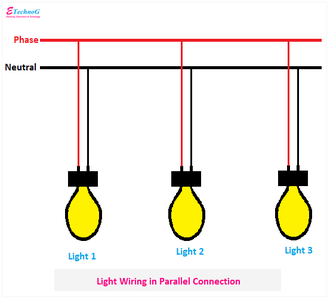

Step 10: Wiring the Bottles in Parallel
Wire the lights in parallel like shown in the third picture of this step. Use electrical tape to ensure there are no shorts and tidy up the wiring. Do also tape the wires to the rope so that they are not dangling and wear out due to weather and wind.
