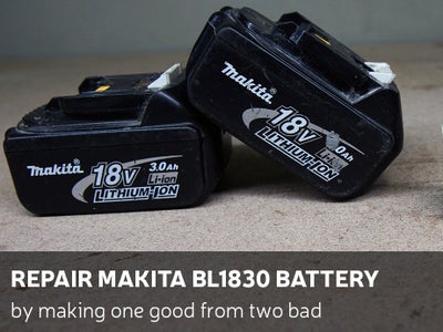

Introduction: DIY: Repair Makita BL1830 Battery by Making One Good From Two Bad
This time I'll take two bad Makita BL1830 lithium batteries and will make one good operating battery. Plus I’ll show you two ways, how to solve protection circuit problem, when it was triggered and regular Makita charger isn’t charging battery any more.How I did it - you can check by looking DIY video or you can follow up instructions bellow.

Step 1: Batteries
I have two Makita 18V 3Ah bad batteries. By saying bad - I mean, that they have low voltage and won't take a charge on regular Makita charger.
I took both batteries a part and found that they have a little bit different protection circuit boards. They are protecting cells from over discharge, overcharge, overheat and are counting the number of charging cycles. Plus one battery have balance wires to each pair of 5 groups cells connected in series.
