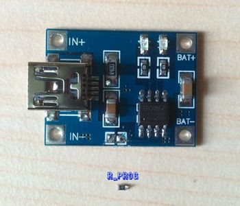

The charger is made by using a most popular IC TP4056.The TP4056 IC is a complete constant current/constant-voltage linear charger for single cell lithium-ion/Lithium Polymer (LiIon/LiPo) batteries. Its SOP-8 package and low external component count make the TP4056 ideally suited for portable applications.If you scare about the SMD soldering,don't worry.We are so lucky that ready to use TP4056 modules are easily available on eBay with very low price.TP4056 can work within USB and wall adapter. Other features include current monitor,under voltage lockout, automatic recharge, and two status pin to indicate charge termination and the presence of an input voltage.
The key point is that you can change the charging current up to 1000mA. If you closely look in to the schematic a 1.2K resistor ( R_PROG) is hook up to pin -2 of the TP4056 IC.The Charging current can be varied by changing this resistance value.The default resistance used in the module is 1.2K which set the charging current to 1000mA.

Step 3: Remove the Prog Resistor
First locate the position of the resistor Rprog (1K2).For easy identify, I have focused it in the picture shown above.
Then carefully remove it from the top of the PCB using a soldering iron.
