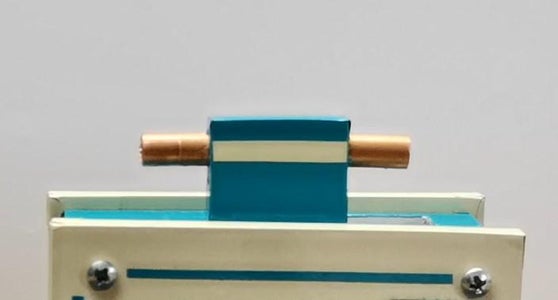

 As I mentioned before, the device is very simple to build and consists of several components:
  - Arduino Nano Microcontroller
  - SH1106(or SSD1306) Oled display
  - and Buzzer
  An ordinary short wire can be used for an antenna, or as in this particular case, a small piece of copper pipe.
 After switching on, the logo appears first, and after a few seconds the main screen. Now we have to wait for a certain time until the value of the EMF field stabilizes around zero, if there is no source of radiation near the device.
 In addition to visual, the EMF detector also has a sound signal with three different frequencies 100, 500 and 1000 Hertz proportional to the strength of the field. The thresholds at which the frequency changes are defined in the code.
Step 3: Electroscope
 This device is also sensitive to static electricity, which means it can also be used as an Electroscope.
  And finally, the device is installed in a suitable box made of PVC material and lined with colored self-adhesive tape. In fact, I used the box from one of my previous projects, so the light sensor have no function in this specific project.
