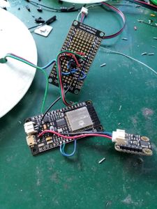

Firstly, connecting D2, D3, D4 to D2, D3, D4 of the FireBeetle Board-ESP32 respectively and drive with high-level. And connecting Vcc to Vcc of the FireBeetle Board-ESP32 too. Then, there are A and B in the Rotary Encoder EC11J, A should be connected to D7, B to D6 and the bottom should be connected to D5. Finally, connecting BME280 to I2C of FireBeetle Board-ESP32.
Step 2: Connecting and Fixing RGB Lights With Dupond, Shown As Below
Step 3: Connecting Output Line to FireBeetle Board-ESP32
Connecting output line to FireBeetle Board-ESP32, Rotary Encoder EC11J and FireBeetle Covers-Proto Board according to the schematic and drawing, shown as below.
Remember to fix the connected electronic circuit with hot-melt glue

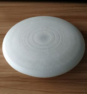

Step 4: Crust Assembly
The curst printed by a 3D printer, you can click here to download the source document.

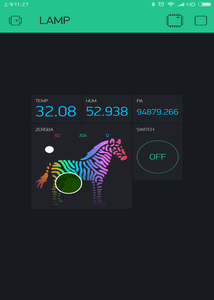

I chose Blynk for the mobile client.
Temperature: V3
Humidity: V4
Pressure: V5
Red Light: V0
Green Light: V1
Blue Light: V2
Switch Bottom: V6

P.s: I love the design of the interface, cool!
