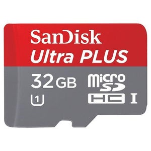

- 32gb Micro SD Card

Once I downloaded the Magic Mirror software to my computer, I transferred the software from my downloads to an SD card, and inserted the SD card into my Pi. The Pi started blinking, and once it stopped, I gently removed my SD card and connected a mouse, keyboard, and HDMI cable to it. Finally, I made sure to connect the Pi's power cable and had to connect my Pi to my network.
