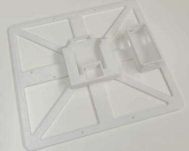

First I 3D Printed the battery adapter that attaches to the back of the LED panel, and the lid of the microcontroller enclosure. You can download all the printable files here.

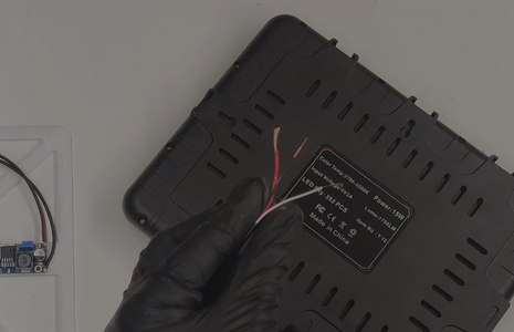

Step 4: Wire the Led Panel to the Control Electronics
Next, I soldered the output wires of the converter, and I moved on to the wiring of the LED panel.
Most of these studio LED panels, have 2 rows of LEDs inside, consisting of warm-white and cold-white. The anodes of both rows are connected together into a single positive (red) wire, and their cathodes go to separate wires (white and black).
The electronics that will control the LED panel are consiting of a microcontroller (which is a custom ESP32-C3 board I made) and an expansion PCB with 2 mosfet transistors. The microcontroller, controls the 2 mosfets of the expansion PCB independently via 2 GPIO pins (8, and 9 specifically).
So, the connections that must be made in this step are the following:
  1. Connect the anodes (red wire of the panel) to the DC-DC converter's positive output AND to the Thorn's power supply terminal.
  2. Connect each cathode (white and black wire of the panel) to the negative input of each mosfet through its corresponding screw terminal.
  3. Connect the negative output of the DC-DC converter to the Thorn's power supply terminal.
