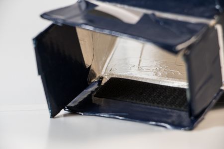

Step 1: Cardboard
Cut the card board like in the photo, the size depends on the flash / strobe you have and the size of the softbox you want, however you should consider the overall weight and make sure the angle of the peaces is the same so they could connect together and form the box
Step 2: Sticking It Together
Tape it using the gaffer tape to form the box, leave the square at the narrow end free.
Cover the cardboard endings to make it more durable.
Step 3: Reflector
Cover the inside with the aluminium tape to form a reflector
Step 4: Connection
Stick one side of the Velcro tape to the narrow ending of the softbox, where the flash / strobe would be.
the other side goes on the flash / strobe.
Step 5: Softening Plastic Sheet
Make a slot along the endings of the box where the plastics sheet sits and thread the plastic sheet through
Step 6: Mount
That is it !
Mount it on the flash / strobe using the velcro to secure it and take grate photos.
