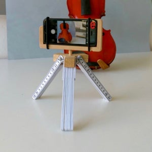

A tripod for about 10$ made from 3 folding metre sticks and some scrap wood.
It took me about 4 hours to complete the project.
I made it for my iPhone SE, but with little alterations on the dimensions on the phone dock you can simply make it for your own phone if you don't own an iPhone SE, 5s or 5. I will include some tips about getting the right dimensions for other phones later that progress.

Step 8: Assemble Tripod
Get the wood screws and washers and assemble the tripod as shown in the picture.
It should now stand steadily and you should be able to unfold the metre sticks 3 times to increase the hight of the tripod.

Step 17: Assemble and Finish
Stick the dock in the hole of the tripod base and your finished. Mount your phone into the dock and fasten with the hair ties.
Your now ready to shoot pictures or FaceTime your gf/bf with hands free.
