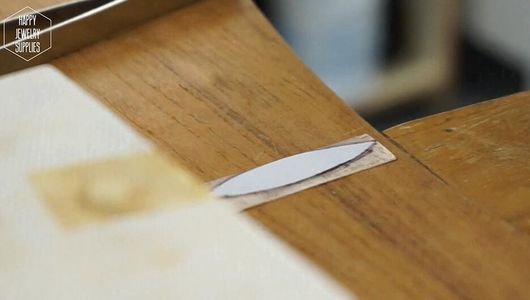

Step 1: Design and Cutting
Design and draw out the shape of a peasecod on the paper with a marker. Trim out the paper-shape with scissors.
