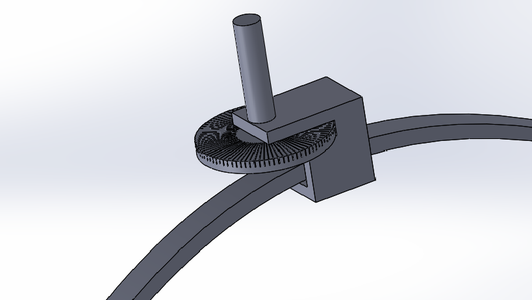

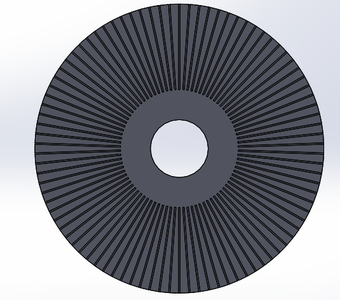

For the mouse inputs we will use a disk with alternating conductive and non-conductive slices, on which two wires, with a small offset, will slide. The board will read the signals coming from the wires, giving us one of four combinations: 00,11,10,01, which we can directly translate in left-right movement.
For the up-down movement, instead of a disk, we will use a plate with the same pattern of 0's and 1's.
As inputs for the module that simulates the keyboard, we will have switches placed on the joint of a rod that will hold the harness. When you step in any direction, the rod will bend slightly, thus opening the switch.

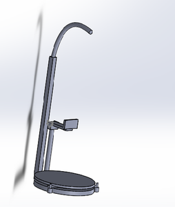

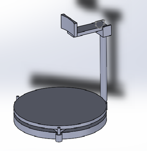

The base should have a low center of gravity, thus a heavy material needs be used. In my case, I used plaster and an antenna disk to make a concave mold, but other means can be used (ex. yoga ball). After the mold dries, it will be placed on two disks of the same diameter made out of MDF or a similar material. A spacer will be introduced between the two MDF disks. In between these disks, a triangle profile will be placed,which has bearings on the edges. Another set of bearings will be placed perpendicular to the vertexes of the triangle and tangent to the disk, on the top. For better precision, more bearings can be used. A rod will be placed on one of the vertexes, as shown in the third picture. This rod holds the harness in which the player will be placed.
Another fixed exterior rod is used to support the wires and also as a reference point for the rotational movement.

As inputs for the board, I chose JB(1 downto 0) digital pins. Considering the sequence ...11001100..., read on the two inputs, we can distinguish between three states of the counters :
1.Count up;
2.Count down;
3. Save the current value;
The Count_Type module does exactly that. If there is a change in the input, then the module sends an appropriate message to the 8 bit counter( implemented in the 8_bit_count.vhd file), which adds or substracts from the current value, unless a reset signal is received.
The same idea is used for the up-down movement of the head, but instead of a disk, a sliding linear profile with the same alternating 0&1 pattern shall be used.
