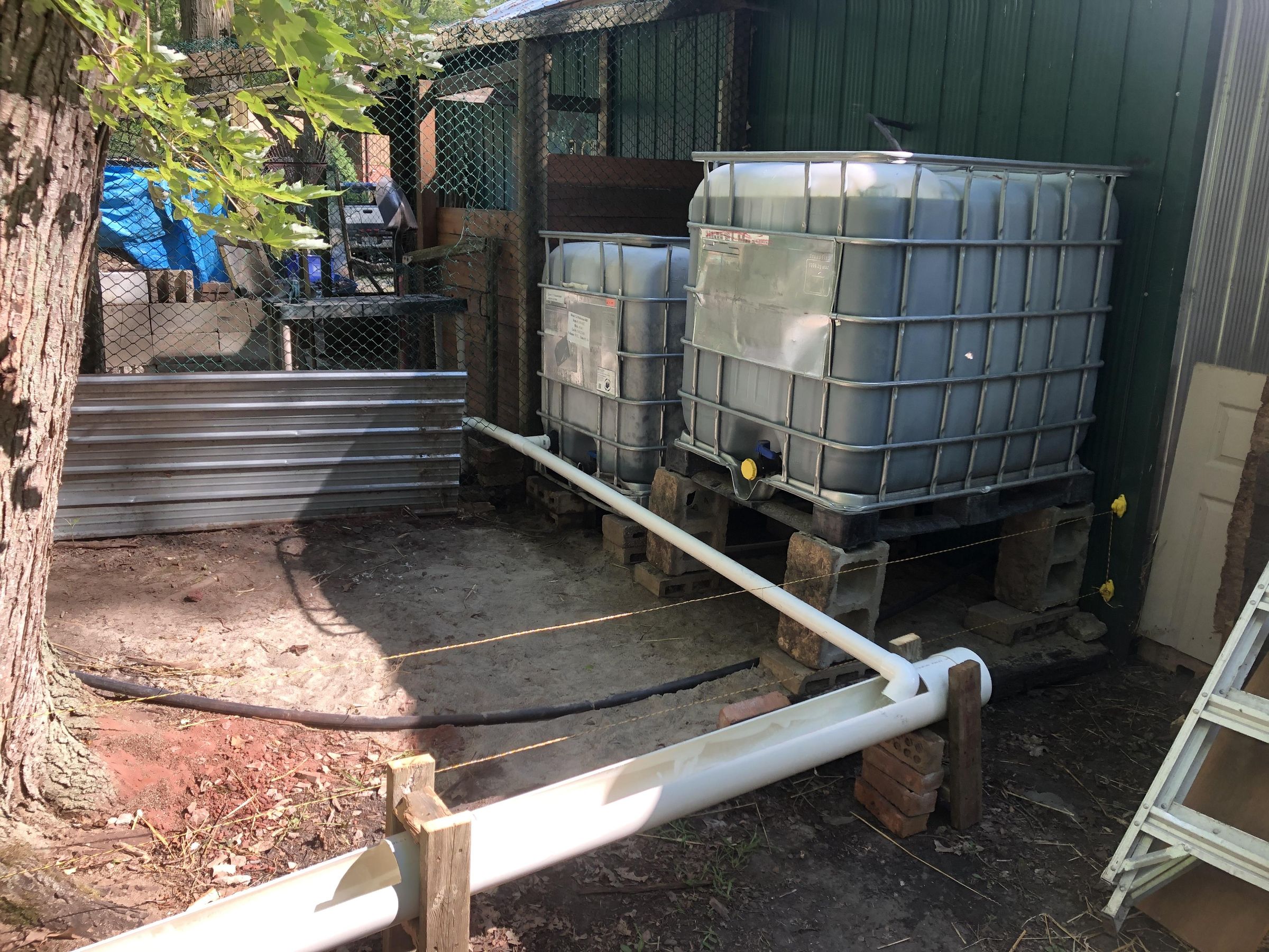

Connect clarifier skim drain to PVC tower drain assembly.
If there is not a forklift available to lift and place the clarifier box (as pictured), two people could safely lift the clarifier.

Question - would it be a good idea to add a downward-pointing elbow on the skim drain intake so as to reduce any surface-floating debris entering the system? Or would that create an air lock and prevent intake at all? Maybe wrap a piece of window screen over the intake?
I have 2 IBC totes under my back deck fed by several downspouts with inline taps from the big orange box store. My plan was to use Berkey filters mounted in 5 gallon buckets to filter it if ever needed for emergency drinking water, but I'm considering upgrading the system. Only problem is I don't have enough room to stack the totes, so might turn them both into filter boxes.
Thanks again!
Reply 7 years ago
Glad you liked it!
You're on the right track to exclude floating debris from the drain. A downward pointing elbow would create an air lock or siphon. Instead, use a tee fitting (as pictured) to drain water from an inch below the surface. The leg of the tee fitting open to the atmosphere will prevent air lock or siphon.
If you're thinking about drinking water application, do your homework to pick the right method to prevent water-bourne illness in the event you have to access the emergency supply totes
Good luck on the project, please share what you build!
