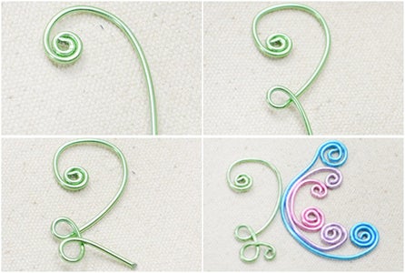

9th, cut a 20 cm length of green wire and do two coils at one end;
10th, bend down the wire and loop twice with round nose;11th, coil the other end.
