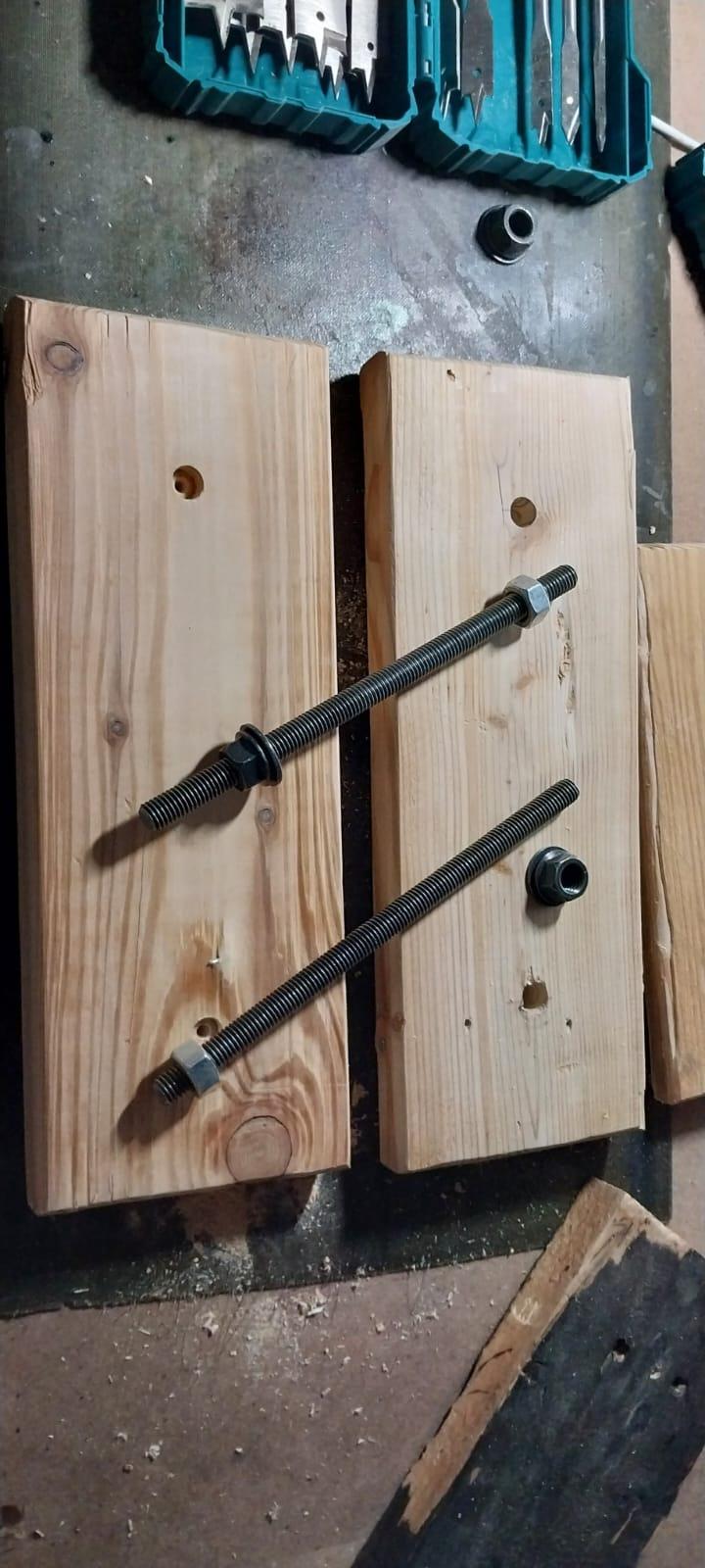

I used :
  • Two simple blocks of wood.
  • Two Metal screw bars
  • Two nuts.
  • A Drill.
  • Sander.
  • Wood stain.

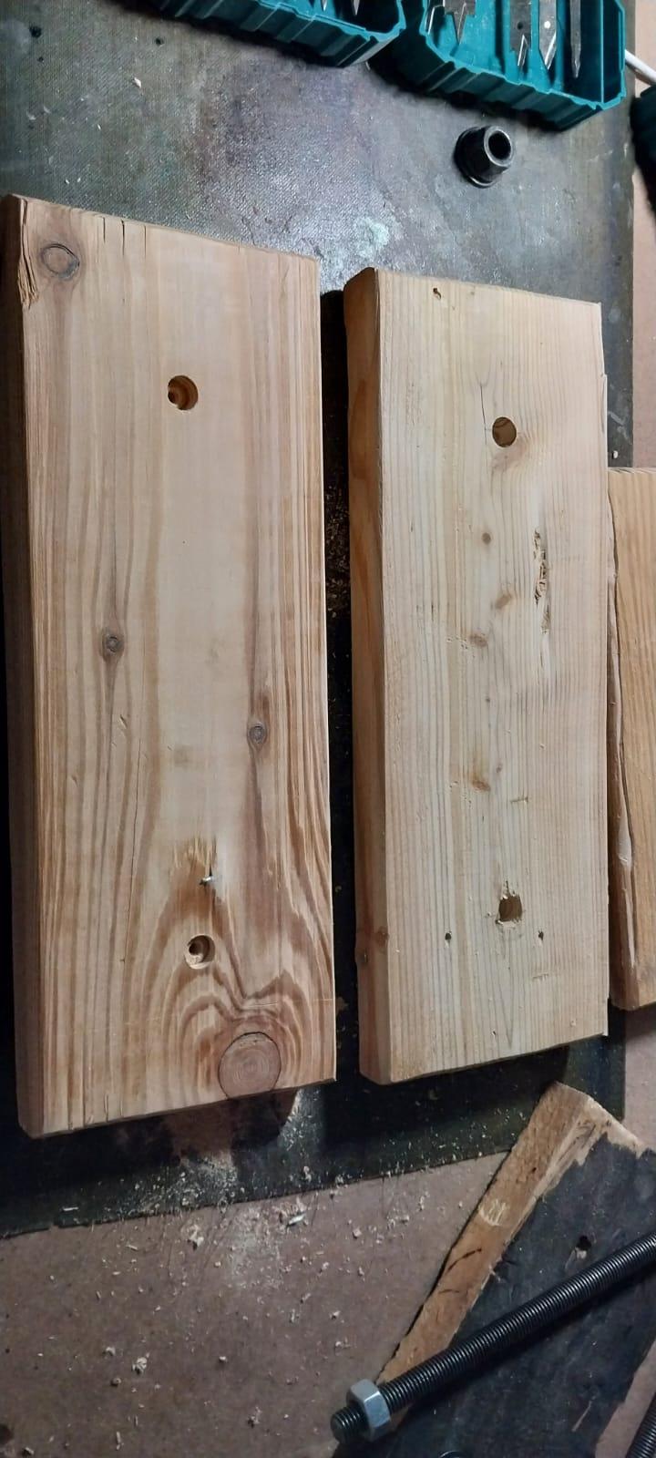

Step 1: Drill 1st Piece of Wood
  • I brought 2 pieces of used wood.
  • Two holes were drill in one of the pieces to cross the two columns through which they were screwed.

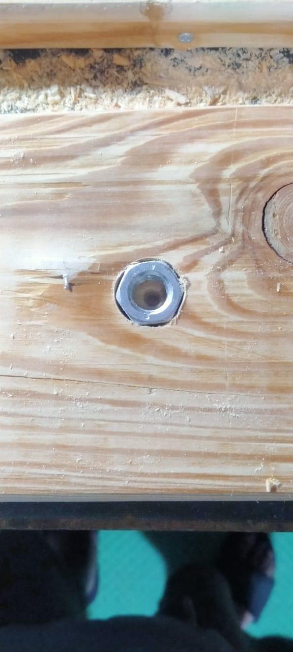

Step 2: Drill 2nd Piece of Wood
  • A cavity was made in the other piece at the same level to place the two nuts in it

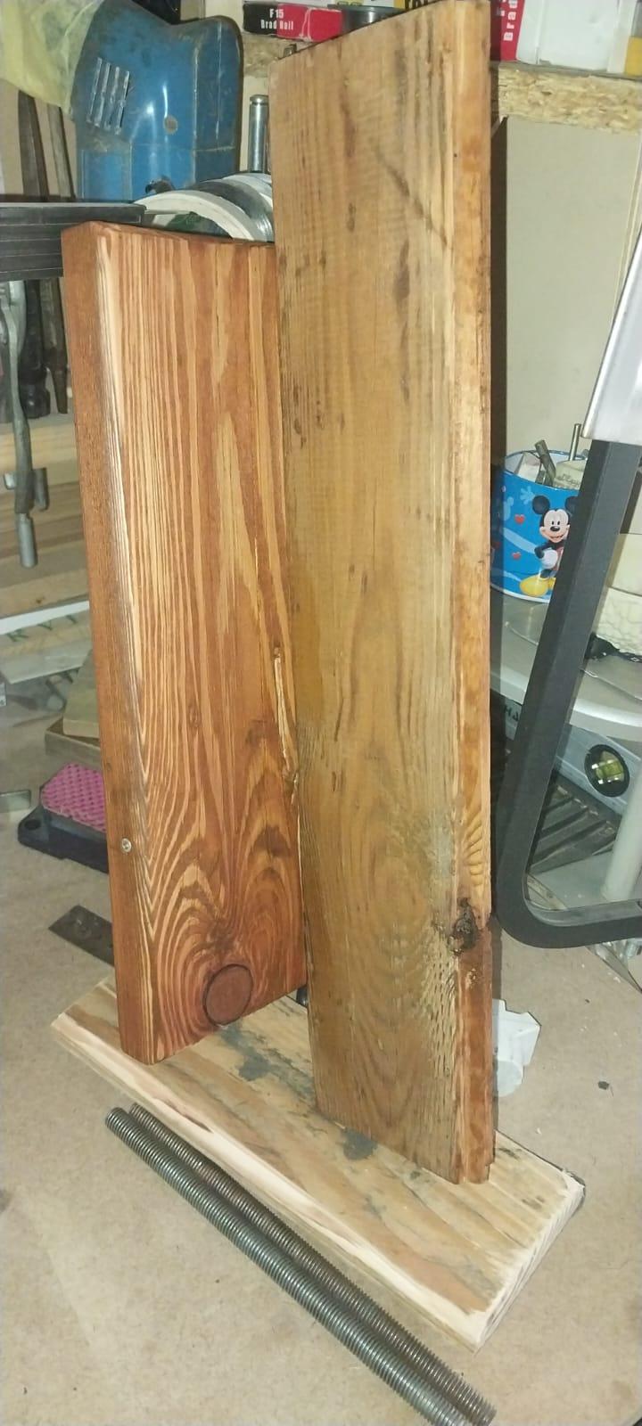

  • The back piece is fixed with another piece of wood to form a base for fixing to the table

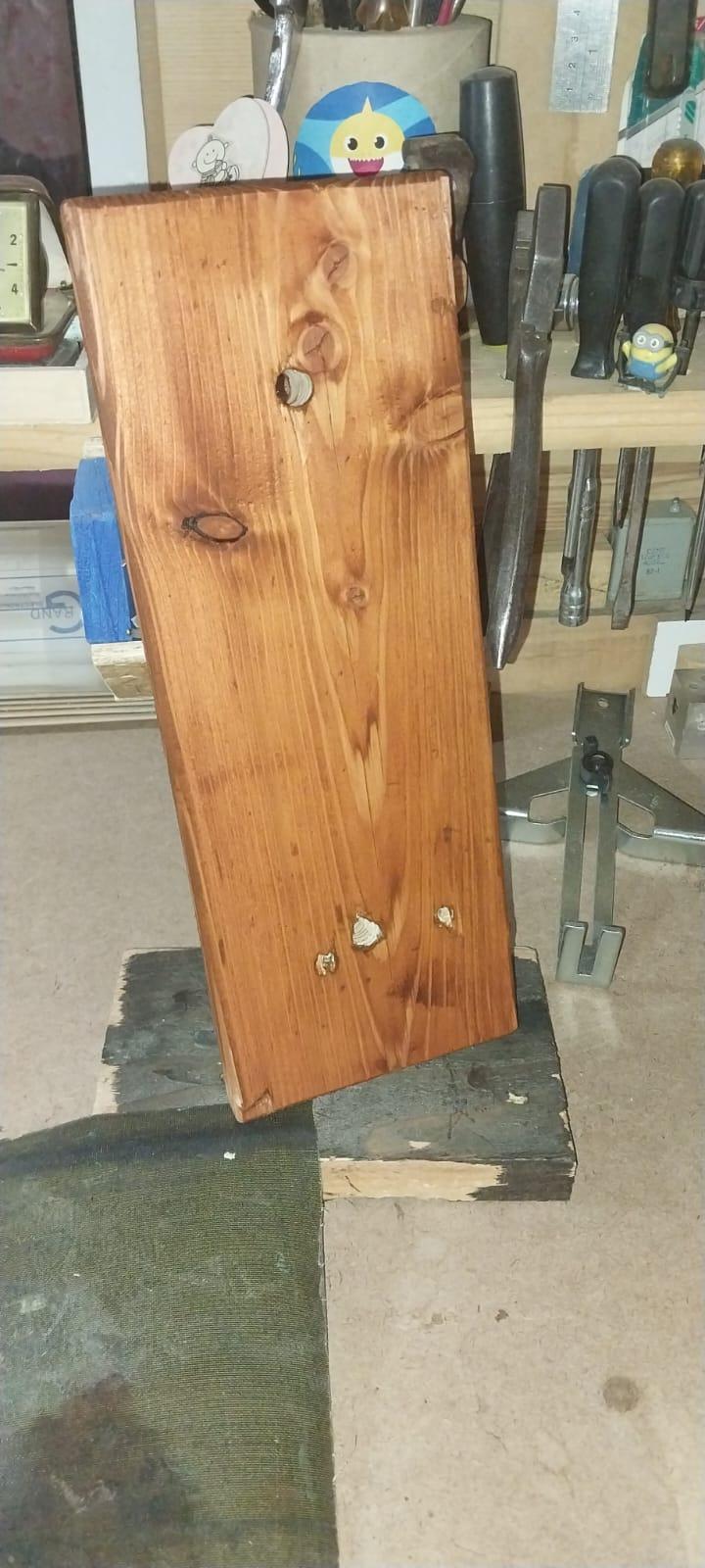

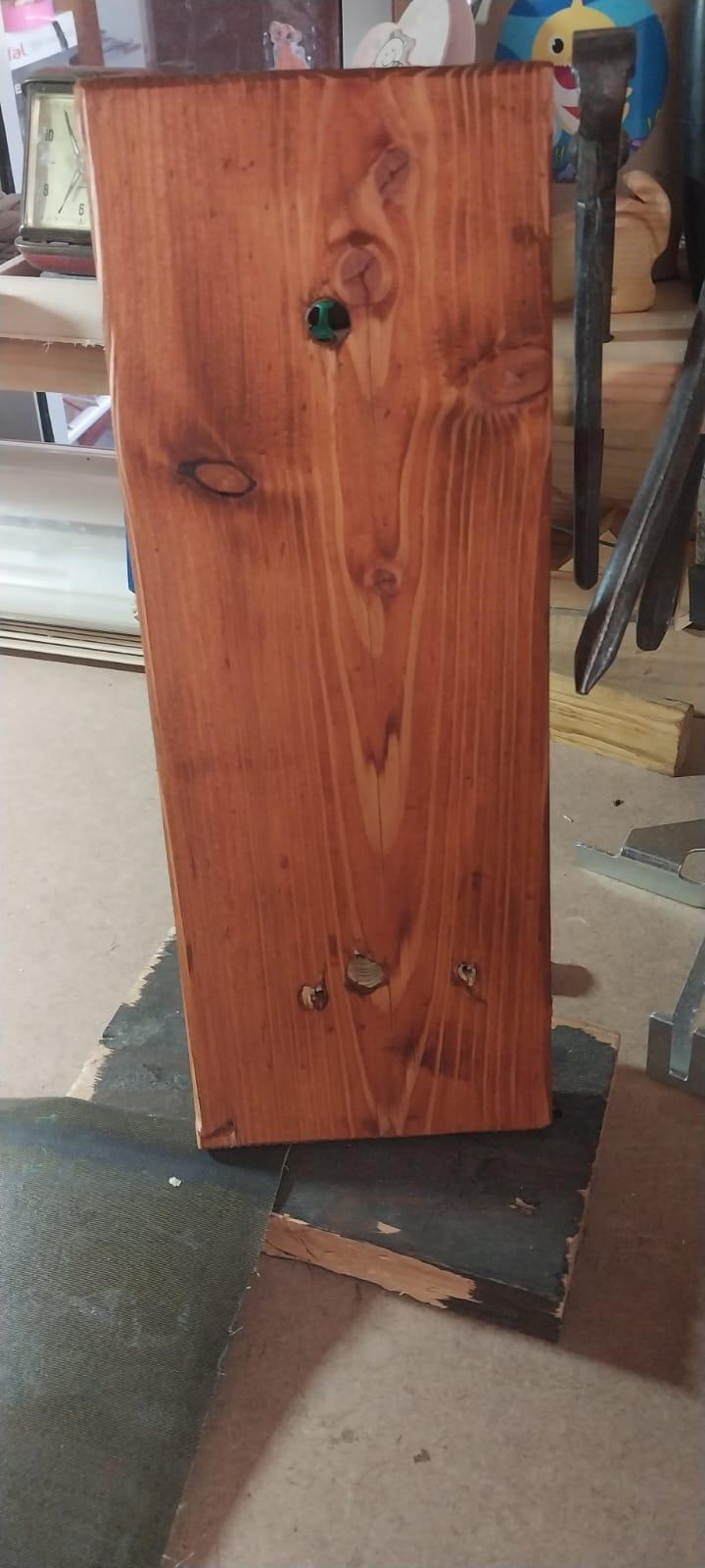

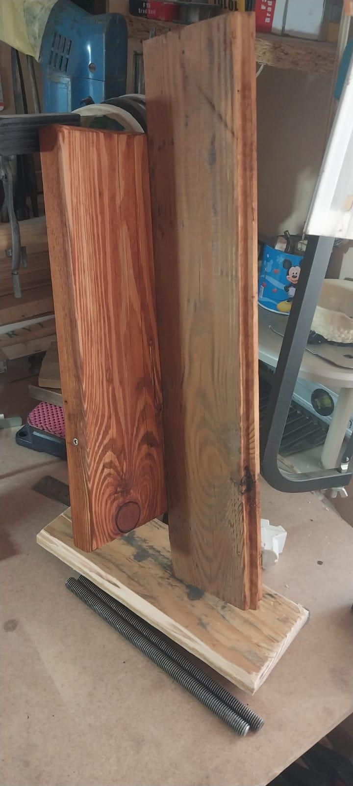

Step 3: Stain the Wood
  • Sand the wood before stained with a dark colour

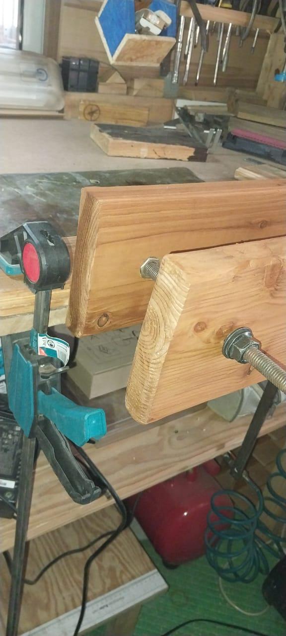

Step 4: Fix on Bench
I fix it on my bench and try it ... it is OK
Need your opinion.
