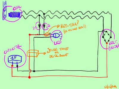

Step 6:
- Ok, i winded up a new coil of quite 1300 turns and seems working better.
- Anyway i need more volts. For this i'm waiting to receive the components to test a joule thief. I'll also try a DC-DC boost to 5V... We'll see.
- I received the capacitor, the circuit i've done makes the capacitor charge while led is already fed by the primary alternate current. As soon the capacitor is full enough, it contributes to light up the led.
At this point voltage is really manageable, so i don't need resistor or voltage regulator for now.
Hints are welcome!
