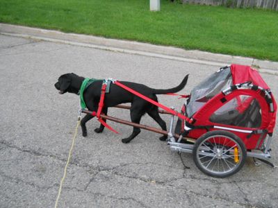

This is the trailer cart I made for my dog Thunder.
It's a folding bike trailer, I made a harness and rigging for him to pull it places.
Aside from the trailer and green dog harness, which I already had, I spent $18 total to make this rig.
A lot of engineering went into this project. If loaded correctly this produces as little as 1kg of downward force on my dog. The poles are only for weight and steering. The upper leads pull the cart slightly forward and move the centre of gravity for propulsion. My dog also has breaks connecting underneath his body which allow him to stop the cart. Finally thanks to Archimedes; Even a completely unbalanced load of 10 pounds will only exert 4 pounds of force spread over a harness with over 3 ft square relative weight distribution contact in the rigging.

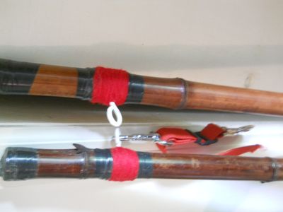

Step 2: The Extender Poles
This area took the longest to figure out.
I needed something entirely removable and yet strong enough to do the task. First I tried broom sticks and bungee cords, just to see if my dog would take to it at all. Turns out, he loved it a lot. I tightened everything up and secured the broomsticks with electrical tape so I could sort out the harness. If you choose broomsticks, I reccomend plastic ones, the metal ones seem to kink easily and become useless. Plastic will just bend. Plus most broomsticks today come with swiveling holes in the handles, making things easier to dream and hook up.
They just look like broomsticks. Remember the more professional you make your rig look, the less likely you'll be interpreted as being cruel.
Tape a grip pattern into the base of the poles, this will help secure them with a lashing later.

You'll need a secure mounting point for the eye screws so once stopped, the trailer won't roll into the dog. It will be stopped by the Brake Straps.
This method I thought of while thinking about wicker furniture. It's like a fiberglass binding
I pre-drilled and sunk the screws into the bamboo about 4" from the top of the pole. I then applied glue liberally to the last few threads and finally again all over the base flange of the screw and tighten flush. Now wrap the flange to the bamboo with the matching yarn. Wrap liberally and sink into the glue pool. Once a nice wet mound of thread binds the eye screw, wrap the bamboo evenly for aesthetic and tie off the end. Cap each side of the wrap in a neat layer of PVC tape for finish and security.
At this time wrap the end nob of the bamboo in PVC tape to prevent scraping and increase comfort levels.

Step 6: Hook Up Your Pup.
First hook up the load loops on the side to the top harness ring. Then the Pull Straps to the top ring.
Finally connect the Brake straps to the lower harness ring and the other end to the pole mounting point.
- Use care here. Adjust your straps so that the harware doesn't hit your dog's legs every step, but short enough to pull to a brake.
