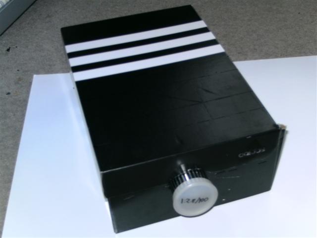

Step 2: Work Out Your Focusing
You will have to work out the focal Range of your Specific Lens, However this is How Mine works in the Image Below, You should Draw up your Plans like this so you Know what you need to do when your build.
Step 3: Build Time!
1. The First step is to Cut your hole that the Slide Projector lens barrel Slides into. Measure the OD or Outside Diameter of the Barrel and cut the hole so that it is a Tight fit and that should allow use of the Thread on the Barrel.
2. Position the Mirror depending on your focusing Diagram at 45 Degrees. You will have to Cut a Hole in the Side but Keep the Cardboard from the Cutout, if you have a handle as well cut a hole for this in the Opposite side.
3. Cut a hole in the top above the Mirror the same size as your iPod's screen with 10mm around each edge to allow for tolerance for adjustment.
4. Test in a dark room to finalize positioning with iPod in Place.
5. When you are Happy Glue gun the Mirror in Place.
Step 4: Add Stands
Get 8 Lego Bricks of eight Spots per Brick. Glue one of them in the Rear Center with Superglue. Join three Blocks two times for Each front corner then glue them to their corresponding Corners.
Keep the spots on the Lego Bricks touching the floor; glue the underside of the Lego Bricks to the Underside of the Projector because of the increased Surface area.
Step 5: Showtime!
Firstly Select your media and then Simply Plug in your Speakers or RCA Cable for sound and then Place the iPod over the Hole on the top and it is Showtime.
You will need to focus it depending on the Throw Distance and the lens setup. Do this by rotating the lens bnarrel on its thread and you may need to push/pull the lens to position it.
