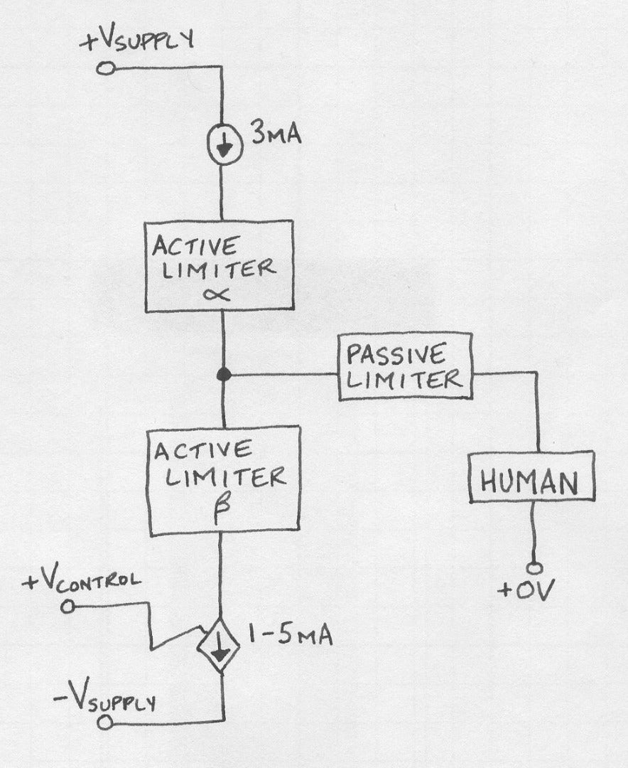

A block diagram has been provided in the hopes of clarifying the following, the principle of operation of the voltage to current converter: When the variable current source is set to 1mA, it only takes 1/3 of the current supplied by the 3mA source and the resulting current through the human is +2mA (3mA-1mA), and when the variable current source is set to 5mA, it takes 5/3 of the current supplied by the 3mA source and the resulting current through the human is -2mA (3mA-5mA). Sweeping the variable current source from 1mA to 5mA proportionally sweeps the current through the human from +2mA to -2mA. The active limiters never become activated during normal operation, and the passive limiter drops no more than 14V unless a fault occurs.
The second image is the actual schematic of the voltage to current converter. The functional blocks have dashed lines around them. If this schematic doesn't make sense to you by itself, I've put more detailed descriptions of each functional block in the next step. Attentive readers will find that the "1 - 5mA" current source is actually capable of going all the way down to zero. The actual current output of the voltage to current converter circuit is bounded as follows: DAC out = 0V, current = +2.9mA; DAC out = 5V, current = -2.4mA; with a linear relationship between DAC output and current between those points. Software must be used to limit the values sent to the DAC so that the output remains bounded within the +/-2mA limits prescribed by the Gottingen protocols (which were originally written for tDCS, yes, I know). The reason the positive current output capacity has that extra mA will be explained in the next step.

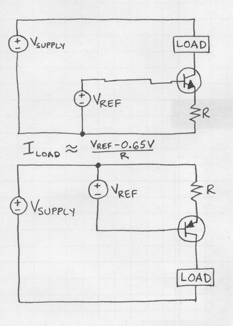

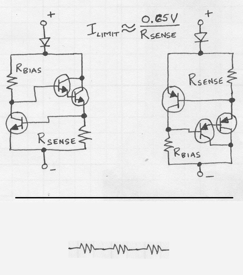

Current limiting for normal operation is governed by simple one-transistor current regulators of the structure shown in the first two circuits. A voltage reference and a resistor are used to set the current, which will be roughly equal to (Vref - 0.65V) / R, as long as Vsupply has enough voltage to force the appropriate current through the load. This equation (approximately) applies for both NPN and PNP implementations, and is a rule of thumb only; it ignores base bias current and a whole bunch of other variables, but it should be accurate to within 5% most of the time. This type of current limiter begins to act in a nonlinear fashion if you allow the transistor to get too close to cut-off. (That's why the extra mA is in the positive supply fixed current source, so the negative supply variable current source never gets too close to cut-off.) The one-transistor current regulator works by maintaining a constant voltage across the resistor, thereby guaranteeing a constant current through the resistor.
The first backup layer of current limiting is provided by three-transistor discrete current limiters. These circuits are neat because they don't drop much voltage when they're not limiting current (under 2V), and they don't need any connections besides one input and one output. This circuit can only limit current flowing one direction, but you can use two of them in parallel (with one reversed) to limit alternating current if you want to. You can omit the diode if your application doesn't have a risk of current reversal. (The tACS shouldn't ever need this diode in its limiters, but I left them in for extra protection.) This three-transistor discrete current limiter limits the current to (0.65V) / (Rsense). The same "rule of thumb only" warning applies to this equation as the one in the paragraph above. Rbias needs to be small enough to saturate the darlington pair during normal operation, but large enough to allow only an insignificant percentage of the desired current limit through (through Rbias itself, that is). Here's how the limiter works: normally the darlington pair is saturated by current through Rbias (current flows freely). When the voltage across Rsense is big enough to turn on the transistor that's not in the darlington pair, that transistor begins turning off the darlington pair by removing its base current, keeping the voltage across Rsense limited to ~0.65V and thus limiting the current through Rsense, and through the circuit as a whole, assuming Rbias is big enough that the current through it can be ignored.
The bottom circuit in the second image is a subsection of the voltage-to-current converter sub-module, which contains an advanced current regulator sub-sub-module whose schematic is pictured here. This sub-sub-module limits current through it to (voltage across regulator) / (3*R). It utilizes three fixed-conductance sub-sub-sub-modules which were produced from hydrogen using the proton-proton chain fusion reaction process.

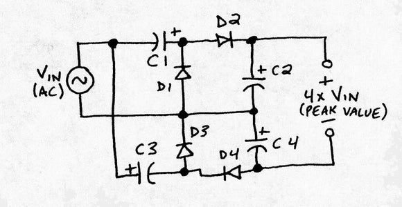

Let's start with the voltage quadrupler. It's the circuit in the first picture, the one with all the diodes and capacitors. Look at D1 and C1. Imagine that the AC supply is at this moment the correct polarity to charge C1 through D1. Now, C1 is fully charged. The polarity of the AC supply switches. Now, C2 charges through D2, to double the AC supply's peak voltage, because C2 isn't just being charged by the AC supply, it's being charged by the AC supply in series with the already-charged C1. So double the AC supply's voltage is now across C2. The same principle works on C3 and C4, so C4 gets charged to double the AC supply's voltage as well, and since they're in series, the circuit outputs 4 times the AC supply's voltage. You can use this circuit after an h-bridge driven by a square wave if you need a simple dc-dc converter, but remember: the output and the input can't share a ground connection! (In my case there is no ground connection on the input since it's just a transformer.) This description ignores forward voltage drop of the diodes. In reality each diode burns 0.7V or so off the total output voltage.
Now we will discuss voltage references. In the second picture, the first two schematics are basic diode voltage references. Diodes drop a roughly constant voltage (0.65V +/- 0.05V most of the time), so you can use them to regulate voltage. The left reference outputs about 2V above ground, the right one outputs about 2V below whatever the supply voltage is.
If you need to regulate voltage, there are a few simple circuits here to use. Probably the easiest is the zener diode based series-pass regulator, the one on the bottom left. It outputs whatever the zener diode's voltage is, minus 0.65V.
My favorite linear regulator ciruit is the discrete active voltage regulator, on the bottom right. R1 tends to turn Q1 on, so the output voltage rises until the base of Q3 is high enough to turn on the darlington pair (Q2 and Q3 that is) and these suck away the base bias of Q1. The summary: This circuit makes sure the voltage across R3 is about 1.2V all the time, and you can adjust the values of R2 and R3 to change the output voltage. R1 needs to provide enough base bias to keep normal operating current flowing, but otherwise should be as large as possible. Vout = ((R2 + R3) / R3) * 1.2V

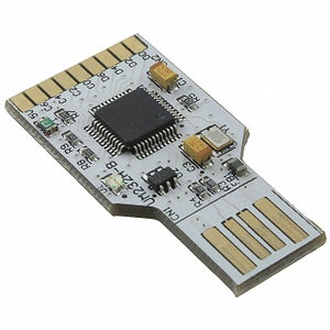

For the beta prototype's USB to SPI converter, a UM232H-B was used. This part has 16ms latency, which is unacceptably high for the final version of the tACS device, but it's the first one I could get the signal through for testing the rest of the system. I'm going to replace it. I've been looking for off-the-shelf solutions, and I've tried the MCP2210 (Don't ever use that part. It's not reliable for me and others have problems with it too.), and looked into using V-USB firmware (outdated: doesn't compile right with current version of LIBUSB). I will be redesigning the USB to SPI converter to use an FT232RL followed by an ATMEGA328. Then the software can talk to the device without needing special driver installation, too. The excessive latency of this part is why I'm not publishing the driver software I've written so far, because the driver software will be completely rewritten for the final version, since I'm changing the USB to SPI hardware the computer communicates through.

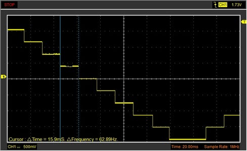

Regulator drift. In a nutshell, I noticed that this device's output current drifts up about 100uA from when it's turned on to when it's warmed up. The output current is based on the voltage reference and +VCC supplied to the DAC, which drifts from 5.15V at turn-on to 5.01V once warmed up. This change accounts for the output current drift I observed, and I can eliminate it by replacing the simple discrete-transistor regulator circuitry that provides the -55V output of the PSU with a high-precision integrated regulator. The three-diode voltage reference in the power supply that provides the +58.25V rail also drifts -- from dropping 1.79V at turn-on to dropping 1.76V once warmed up. Since I'm putting precision regulators in the power supply I may as well add one there too.
USB to SPI conversion hardware latency. The latency isn't strictly the problem here, but I need the time between samples to be smaller. 1ms at most, ideally. I believe the best solution is to send the output data points in blocks from the computer to an intermediate microcontroller, which will send each data point to the DAC one at a time.
