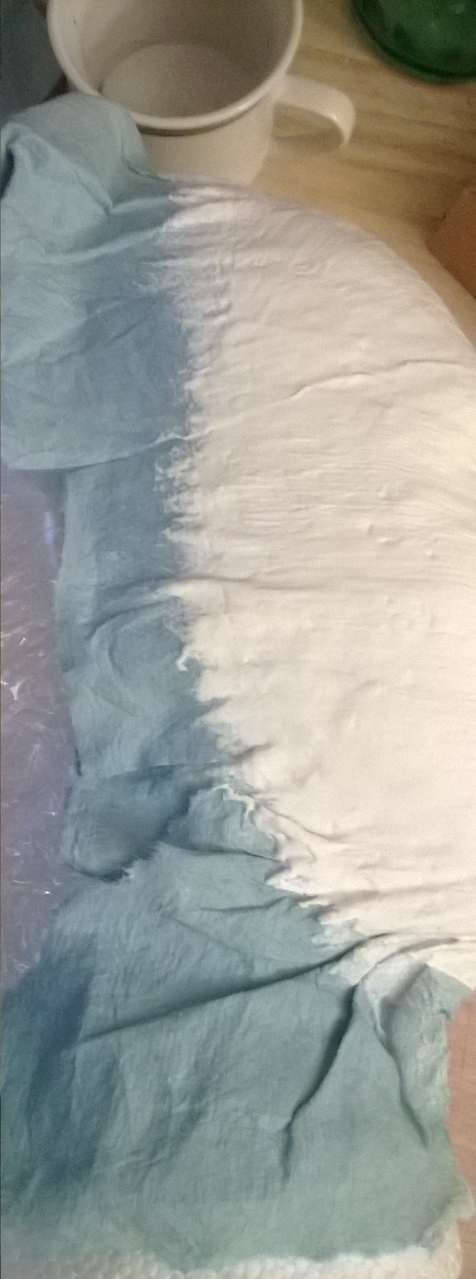

Step 1: Making the Base Mask
The base of the mask will be made out of paper mache, specifically a plaster based paper mache. Some human features need to transfer into the mask so use a foam head form as a base.
Start by mixing the plaster paste. The recipe listed below should be enough to give the mask an under and two top coats and have a little extra left over. Also once the paste is mixed there will be about 15 minutes of work time (the vinegar gives it that extra work time).
Plaster Based Paste
Mix:
1/4 cup of white glue
1 tablespoon of cold water
1 teaspoon of vinegar
Mix in:
1/4 cup of plaster of Paris
Tear the shop towels in half and soak them in water. Make sure to ring them out. Paint the surface of the head form with the plaster paste and then stretch the damp towels over your foam head and smooth out the towel as best you can starting with the features on the front of the mask and working back towards the back of the head. Try to layer it so the seams of the paper towel are not sticking up too much. Now paint on the plaster paste with a medium brush, taking care around the openings to ensure they do not get covered in paste. After letting it dry, add a second layer so it will be more sturdy.
Once the second layer has dried it's time to cut off the fringes of paper towel.
