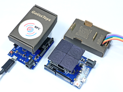

I ordered a Mini GaussSense on their online store, and it came with a bundle of wires, a Mini GaussSense sensor, and a magnet in a box.
Mini GaussSense is a sensor that can track the orientation of a magnet, so I vertically attached a magnet on the bottom of the Minifig and thusly the sensor knows its orientation.

As for the extension on the hardware side, Mini GaussSense could be combined together forming a grid with larger sensing area (esp. for 2D movements.) using an 2x2 Arduino shields. Pairing with GaussToys' NFC module is also an option to get physical feedback or identify different objects.
