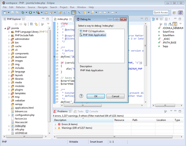

    4. Click in the toolbar debug button (small down arrow) >
      Debug As > PHP Web Application.
    5. Next time you can click the Debug button in the toolbar instead.
    6. Set Launch URL to: http://localhost/index.php > click OK.
    You'll be asked to switch to Debug perspective. Answer with Yes. You can switch back to PHP project perspective by clicking the small PHP button in the upper right corner.

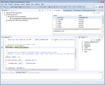

    The web browser displays a blank white page, because the breakpoint in Eclipse should be reached on index.php line 12.
    Now you should be able to step through the code with shortcuts:
    • [F5] Step into
    • [F6] Step over
    • [F7] Step return (or out)
    • [F8] Resume (or continue)
    Now press 3x [F6].
    The $startTime variable is displayed in the Variables tab. Hover over the variable to see the contents of the variable.
    Press [F8] to resume. The entire website is now displayed in your web browser.
    Refresh your web page in the web browser to reload the page. The breakpoint in index.php line 12 is reached again.
