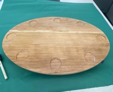

Once my board was fully designed, I imported it into Fusion 360 where I added in the measurements of the board I glued up so I could see exactly how my designs would be placed. After I had a board in fusion the same size as my actual board I created tool paths so I could export it to the router to cut out the circles and profile of my board.
Step 4: Using the Router
Once my project was finished in Fusion I exported it onto the router. I used a 1/8 size bit to create the profile and moon phase circles.

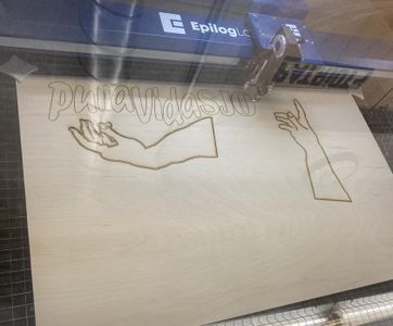

Step 5: Using the Laser
To use the laser I changed the colors of my lines so it would cut the outside outline the inside and burn the space in between. Red lines cut the outside, blue create outlines and black does the burning. After the hands were finished I sanded them to remove any burn marks the laser made on the wood.

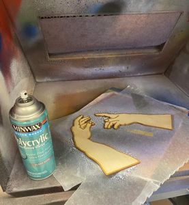

Step 6: Polyurethane

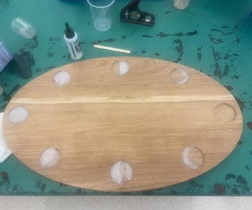

Before epoxying I needed to ensure that the epoxy wouldn't leak into the wood, so I used polyurethane to seal the wood. I did multiple coats on both my board and the hands. I focused especially on the circles on the board because that's where the epoxy will be poured.
Step 7: Epoxy
To create the moon phases within the circles I used transfer paper to create forms so I could pour the epoxy and have it in the different moon phase shapes. In order to dye the epoxy white I used mica powder and acrylic paint to give it a moon like effect. Once the white was dried I painted the empty spaces black then poured the black epoxy. After pouring the epoxy I used a heat gun to smooth out the surface and remove any bubbles that were created as I was pouring it. I then used denatured alcohol to remove any epoxy on the surrounding wood.
Step 8: Finishing Touches
To attach the hands to the board I used gem tack as glue. I put small little dots around the perimeter of the hands then placed them onto the board. After placing them onto the board I added a heavy object on top so they would adhere to the board.
