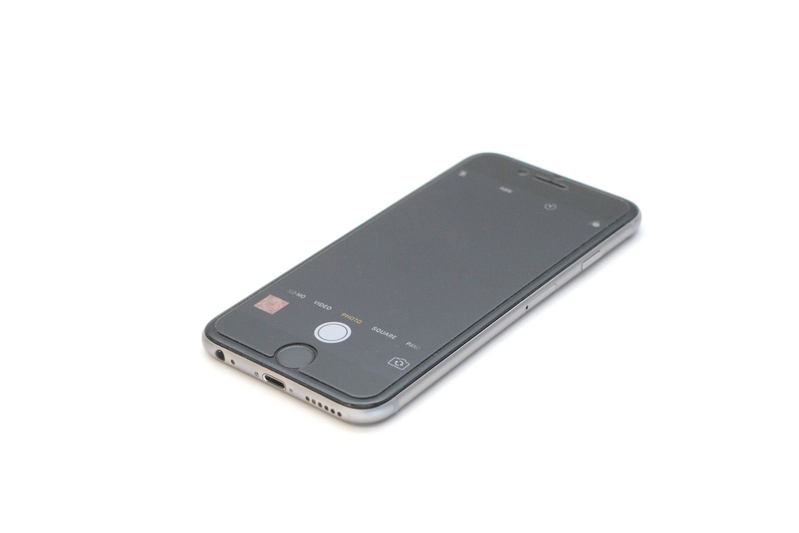

A smartphone is a detective's best friend. When doing topic and user research, being able to take photos, videos, and record interviews with one small device is amazingly convenient!

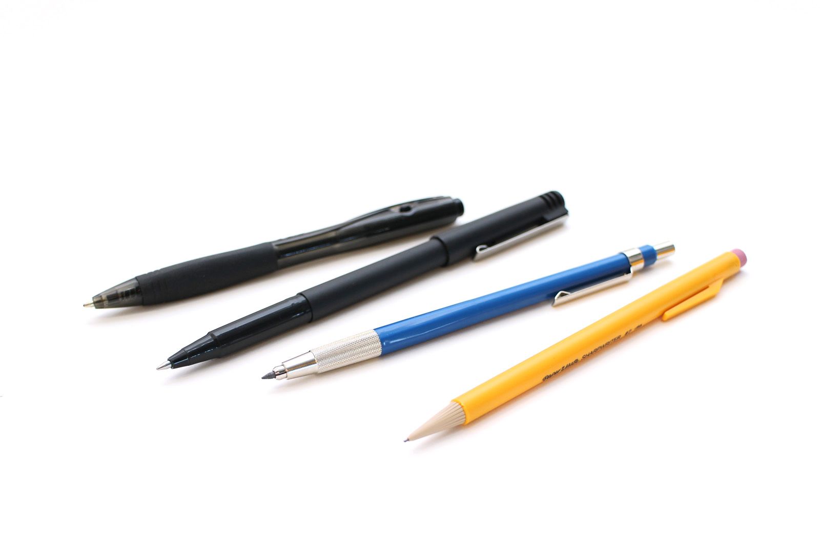

Ball point pens and mechanical pencils are the norm for sketching both in sketchbooks and for more refined drawings.

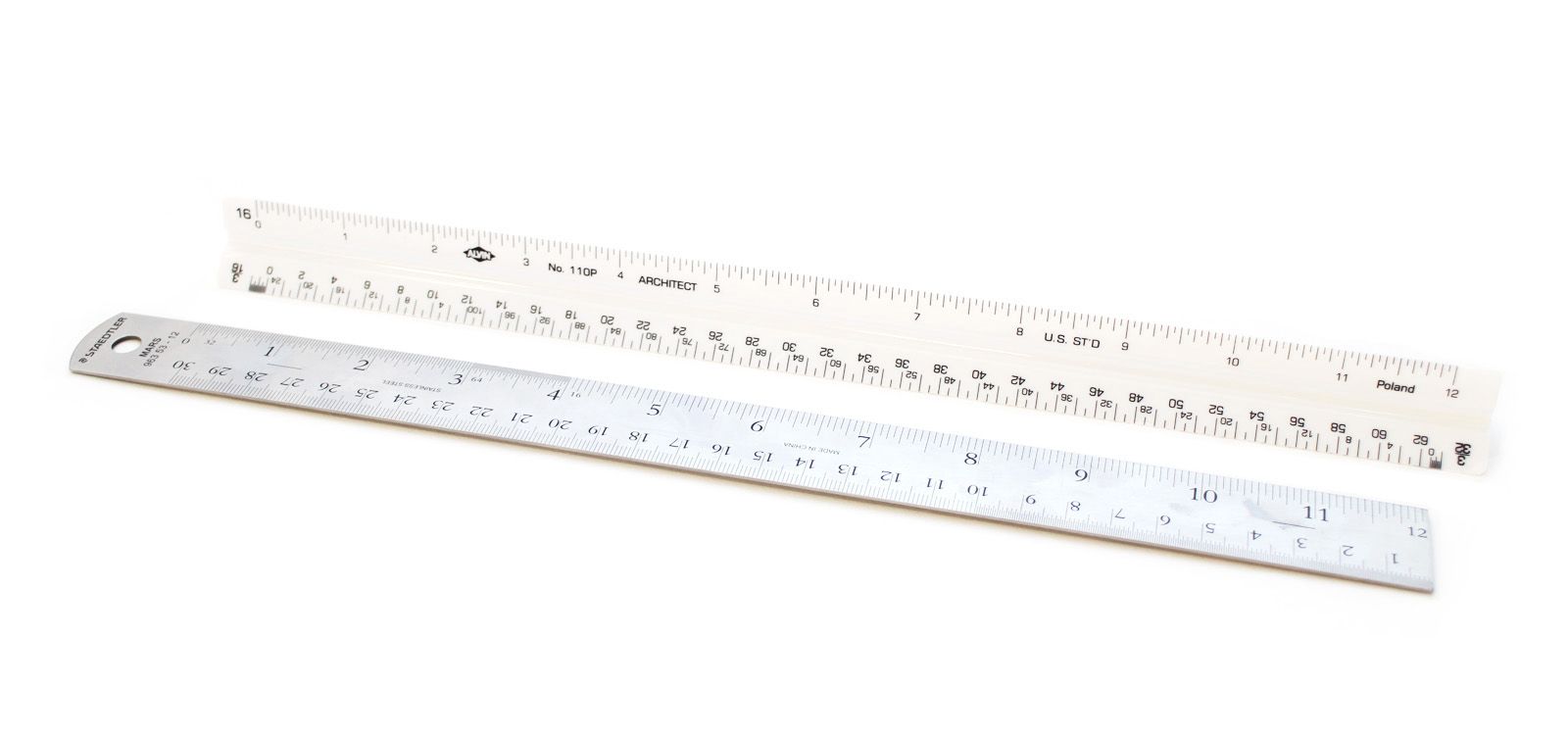

Rulers can be helpful to use when you're just getting started with sketching. Eventually, if you practice enough, you will be able to freehand straight lines, but there's no shame in getting help until then! :)
NOTE: Architectural scales (rulers) like the white one above are used to create drawings to scale. This is helpful is you're designing furniture or other large items.

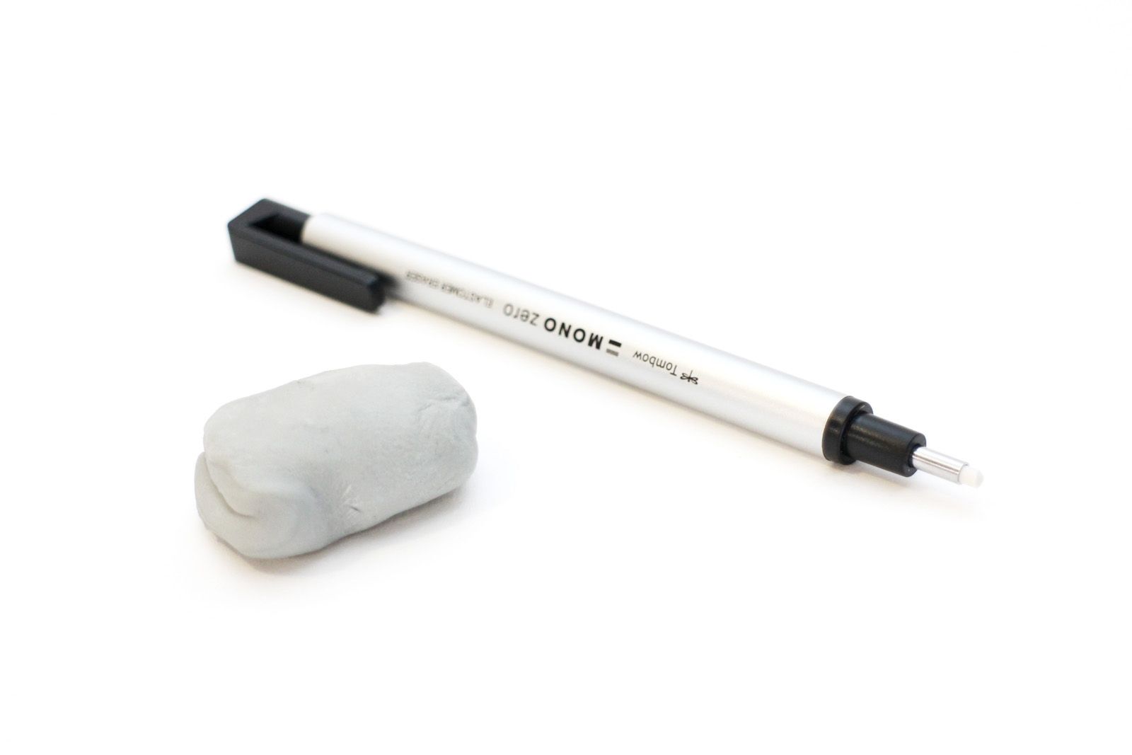

I like to have a variety of erasers on hand when I'm drawing. The fine tipped Mono one above is great for removing pencil marks from inside of drawings and the kneaded eraser is good for large area erasing. Gum erasers (not pictured) with their nice crisp corners are good at both.

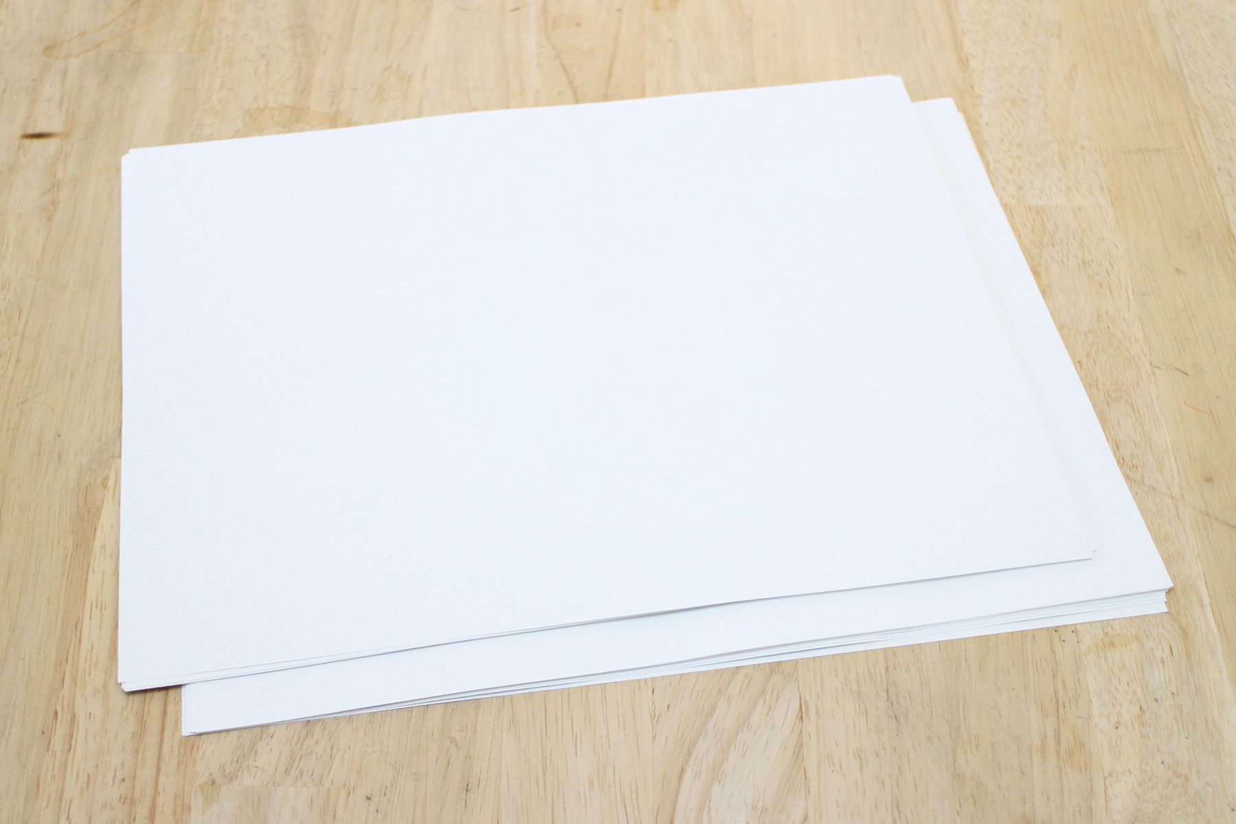

Good quality 8.5 x 11 (A4) printer paper is perfect for refined sketching.
Tracing paper is invaluable to have when you're learning to draw. It allows you to easily iterate on your drawings by tracing over your first one and making small changes, instead of having to start from scratch.

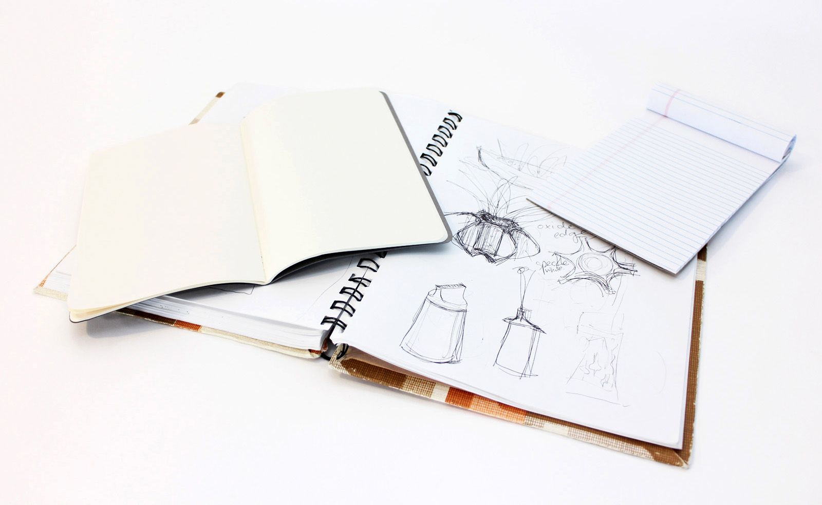

Using sketchbooks is my favorite way to keep track of my written and doodled ideas. There are many different kinds in all different sizes: spiral bound, perfect bound, stapled, with blank, grid, or lined paper. Try a few different styles until you find one that works for you!

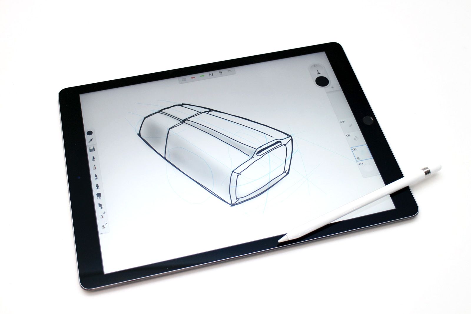

If you prefer a more 'new fangled' approach to life, using a tablet is another method of creating and keeping track of your sketches. The device will store all your sketches and they can be easily transferred to your computer (and the cloud) for long term storage.

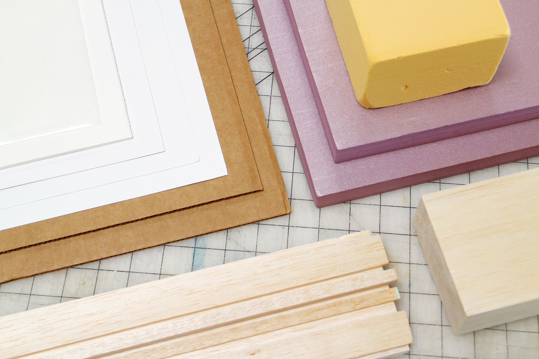

The most commonly used materials for rough prototyping are foam core, cardboard, balsa wood, acrylic, blue or pink foam (Styrofoam SP-X), and balsa foam. All of these materials are inexpensive and easy to work with – with the exception of balsa foam, which is super easy to shape and great for a beginner, but a little pricey.

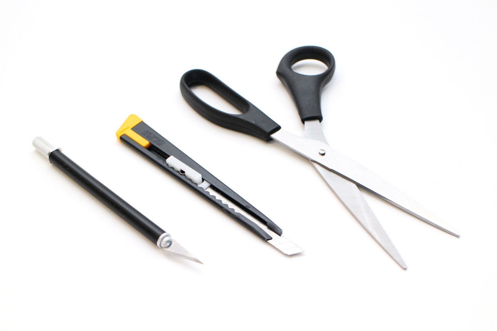

Cutting tools are essential to rough prototyping. I routinely go between using all three of the above 'sharps', so I recommend investing in both an exacto knife as well as a box cutter, along with a high quality pair of scissors.

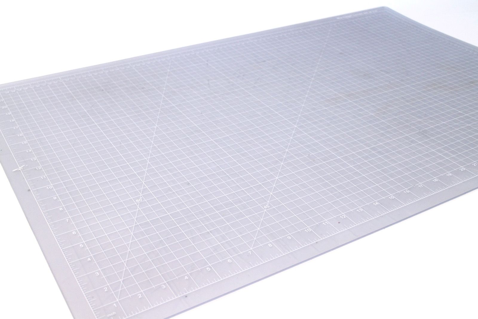

A large cutting mat can turn any surface into a work surface. These are great for home or studio/office use.

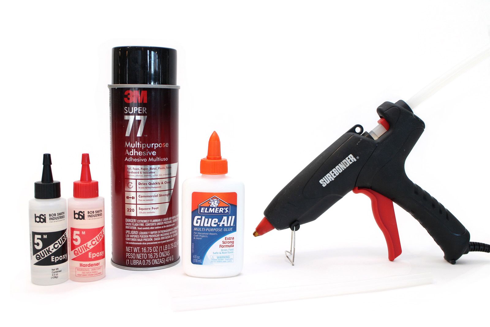

The adhesives that I use the most for rough prototyping are: 5 minute epoxy, permanent spray adhesive, white glue, and hot glue. They all shine depending on what kind of 'stick' you need. 5 minute epoxy is the king of subtle strength, spray adhesive is for glueing flat pieces with a lot of surface area, white glue is gluing things into other things (i.e.: a dowel into a hole), and hot glue is good for fast and loose connections. It's strong, but not always tidy looking.

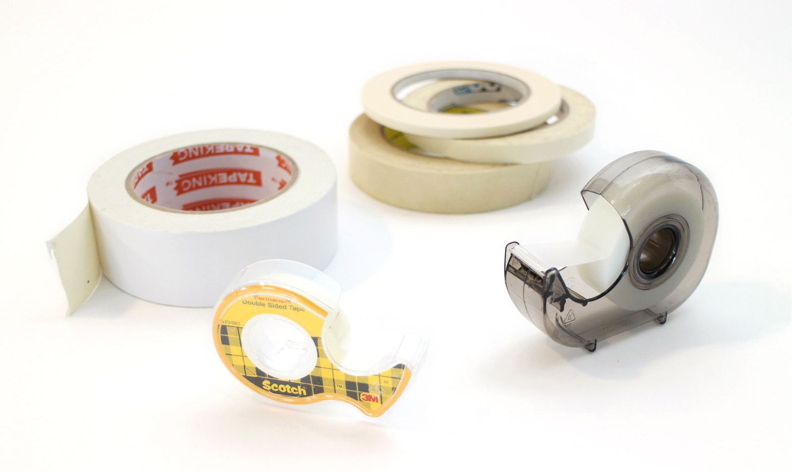

I use tape if I want: removable connections (masking & scotch) or super controlled surface contacts (double stick tape in place of spray adhesive). Masking tape also works well as a binding strap and prototype hinge.

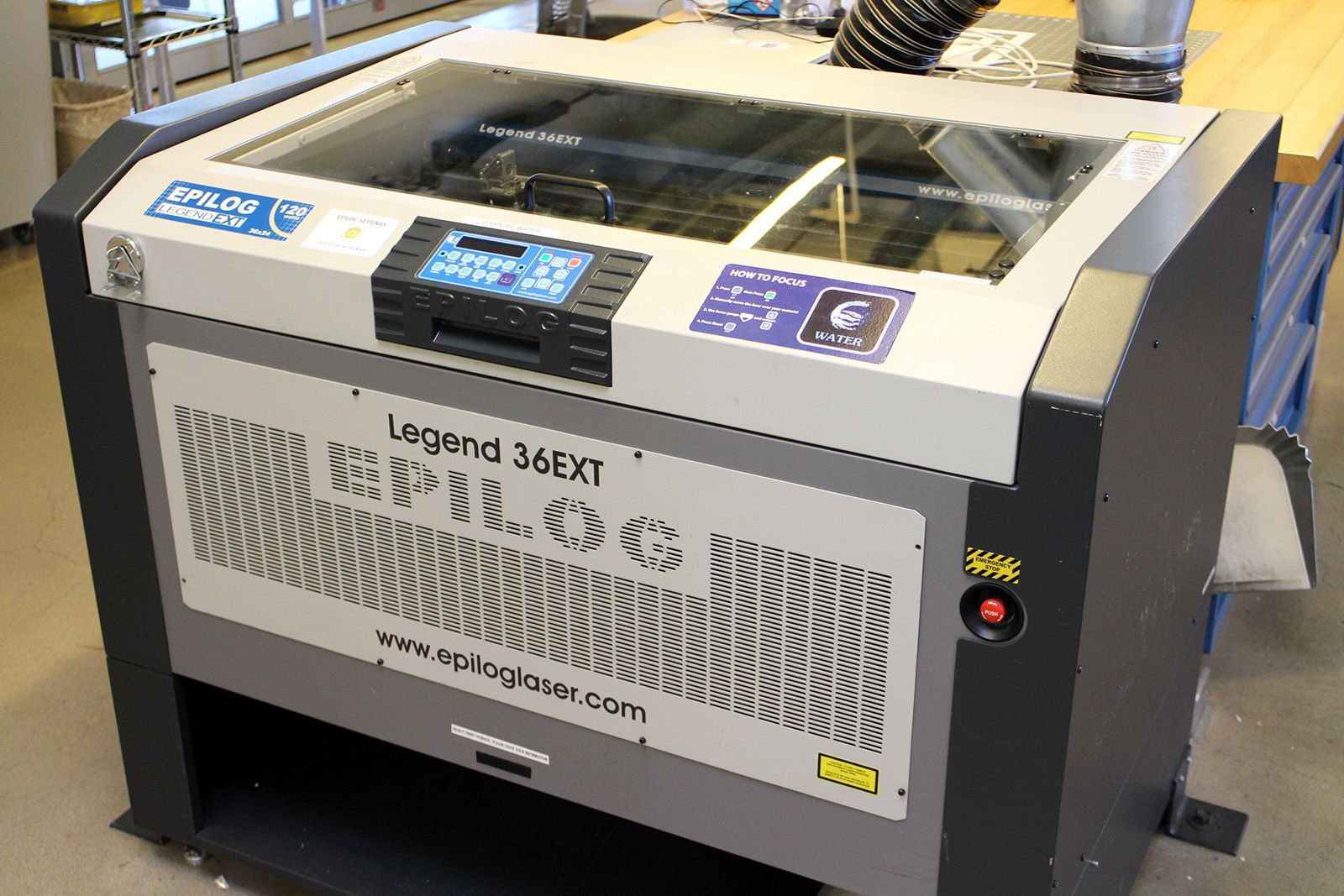

Laser cutters are the jam. They are easy to use and don't require learning any extra 'middleman' software. AND they are very versatile in that they can cut a WIDE variety of materials like paper, cardboard, acrylic/plexiglass, wood, leather, cork, etc. I'll talk more about laser cutting in Lesson 5.
If you don't have access to one, there's a good chance that there is a business in your town that you can hire to cut things for you. If not, there are lots of great online companies that will make your pieces and ship them directly to you, like Ponoko.

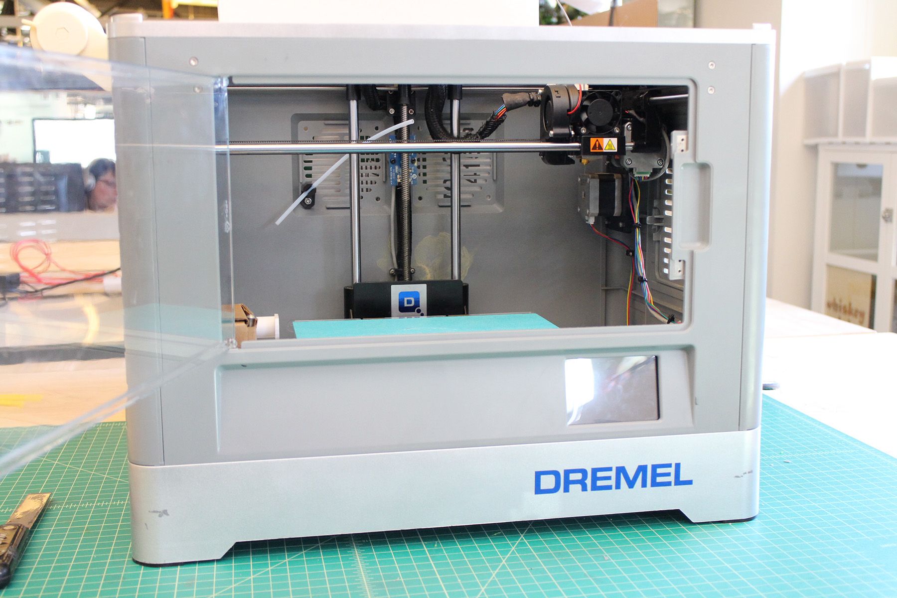

3D printing is all the rage these days and can be very useful for rapid prototyping. You can make whole parts, connectors, casings, really anything you can imagine! They are limited in that most of the materials available to print with are not super 'long term use' durable (with the exception of metal printers), but they are perfect for making prototypes (or parts of prototypes). I'll talk more about 3D printing in Lesson 5.

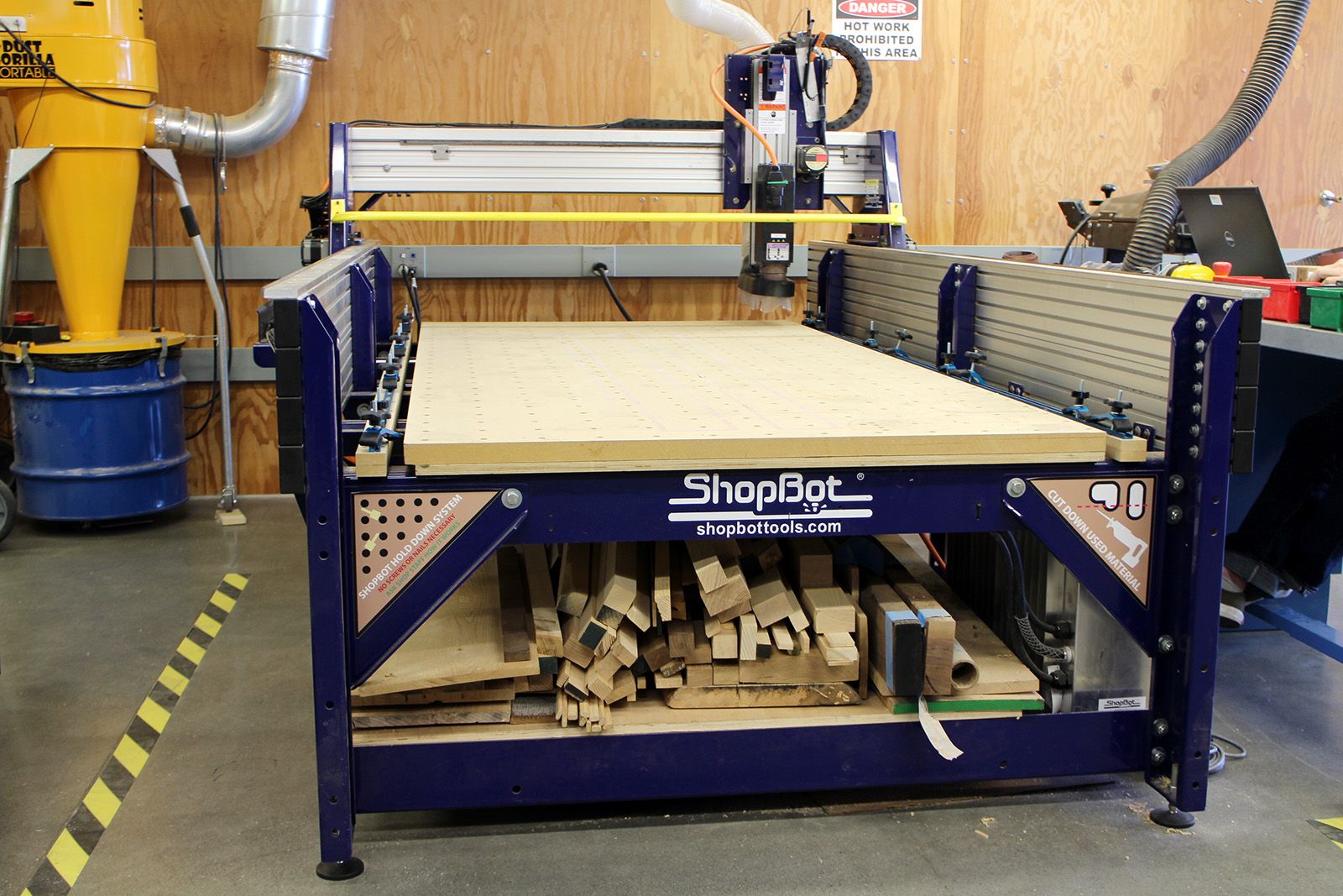

CNC machines are incredible useful if you're making wood or MDF prototypes. They can be used to cut out shapes or mill out internal shapes or depressions. I'll talk more about CNC use in Lesson 5.
