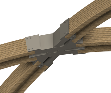

Step 4: Supporting Arches
Create two arches to support your bridge. They could be overhanging like mine, on the sides of the bridge, or below the walkway.

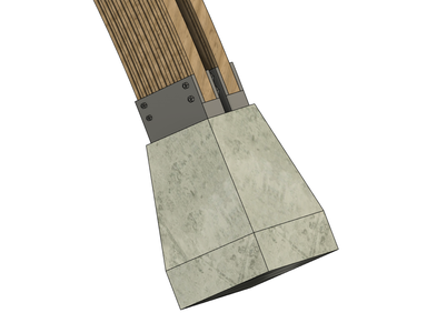

Inspired by the Olentangy River bridge, I made two wooden crossing arches that would help to suspend the base structure of the bridge. The fixtures that attach the wood to the concrete stand-offs are made of plain carbon steel, the industry standard, and would be connected via internal bolts sealed in the concrete. The joint between the two arches is also made of the same plain carbon steel. The wood itself is treated redwood, as its better suited for outdoor environments.

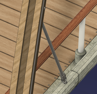

Use rope wire to strengthen the design of your bridge (In construction terminology, those metal cables are called "rope wire"). This usually means attaching wire between the walkway and structural elements like supports and arches.

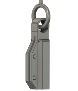

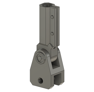

I attached 8 lines of Warrington braided wire rope from my overhanging arches to the sides of the bridge. These lines will distribute the weight of the bridge across the two arches, pulling them down. Arches are extremely strong, so this setup allows the bridge to be incredibly resilient to downward force. To attach the cables, I designed two adjustable cable mounts: one for the wood arches, and one for the concrete bridge. The one for the arches mounts into the slot in the wood framing. The other one is bolted directly into the concrete siding.

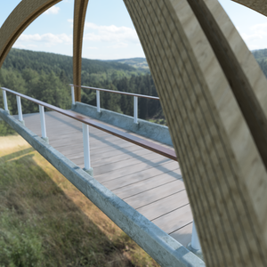

I added a lot of simple lights under the railings so people know where to walk if it's late. I then added 4 brighter lights to the underside of the arches. I also redid the creek and used some real water textures.
Step 9: Renders
Get some great images of your completed design in the render workspace. Go for some at night and some during the day. Try to get shots that show off the detail of the bridge and its full scale at the same time. This step is especially important if you ever want to show off your project, especially if you were to actually make the bridge.
These were the best renders that I got. I made sure to capture some with detail and some of the entire bridge.
