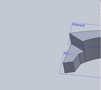

Step 3: Create a Reference Plane for the Teeth
Create a reference plane on the top side of the ratchet and draw a rectangle. The points of the rectangle should connect the inner corners of the two arcs and be large enough to extend the length of the tooth.
Step 4: "Extrude Cut" the Rectangle 10mm Downwards
Repeat this step on the other side of the ratchet but draw the rectangle on the original plane and extrude cut upwards 10mm.
