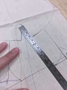

Step 2: Preparing Your Pattern
I decided for my design to use a basic sleveless shirt pattern, it's one of the first things they teach you at Fashion School.
However, I wanted to add scallop designs at the edge of the shirt and make into a crop top. I also wanted to have an open back. You can be as creative as you want with your pattern just don't forget to mark everything.
When you are finally happy with your design
1) Take a good photo of it from the top
2) Use your ruler and take all the measurements of your shirt and write them down
