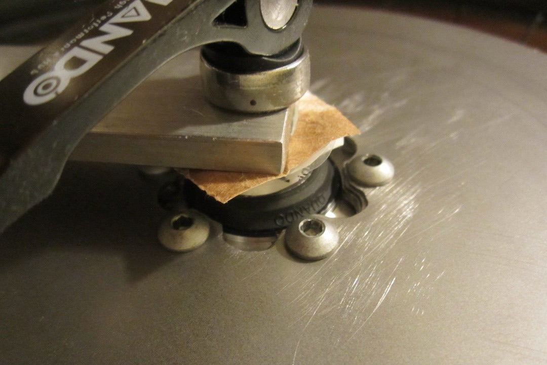

Step 1: Supplies and Setup
In order to test the idea of electromagnetic braking, there needs to be an apparatus with which we can experiment. We could use a bicycle, but that would be difficult to control. Instead, a single wheel should suffice. I used a 29 inch mountain bike wheel, mounted in a simple, steel frame. I also used a vise to secure the frame. To collect data, I used an Arduino Uno R3. Some old supplies were used to manipulate the electrical current. Another Arduino R3 with an H bridge and breadboard was also used to manipulate voltage; however, that part was not absolutely necessary. For the data synthesis and collection, I used a computer running Windows 8.1, Arduino IDE 1.0.5, and Excel 2013.

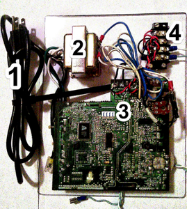

Step 2: Power Supply

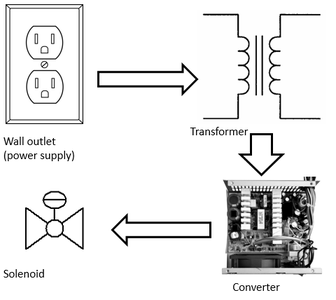

A 24v DC Parker solenoid was used as the electromagnet. Because a 120v AC power outlet was to be used for the power supply, I made an apparatus to convert the AC to the desired current DC. It is composed of four main parts: a power supply, a step down transformer, a circuit board, and a terminal strip. The transformer converts 120v AC to 24v AC and is connected to the input of a circuit board recycled from an old CD player. Embedded in the circuit board is a converter which provides a DC output. I had to solder the wires from the transformer to the power input on the circuit board. I was then able to use the power output wires to relay power to the terminal strip. I used male spade connectors and then some brass brackets on the terminal strip to ensure a secure connection. Everything is secured on a polycarbonate base to avoid undesirable movement during the experiment. In the picture, 1 is the cord connected to the transformer, 2 is the transformer itself, 3 is the circuit board, and 4 is the terminal strip.
If you are not using the h bridge for voltage modulation, I would recommend using a simple rheostat. I had a power strip connected to the wall outlet which acted as a switch. I could then set the rheostat to a particular setting, record the corresponding voltage, and commence with testing.

Step 4: Electromagnet
The electromagnet is the key component of this project. I used the only one available to me, which was a Parker Skinner Valve solenoid 24v DC. Just about any reasonably sized electromagnet should suffice for collecting data, but if you are interested in implementing this system on a bicycle you will, as we shall see, need a much larger electromagnet. In order for the electromagnet to function properly, there needs to be a ferromagnetic disc upon which the electromagnet can induce a magnetic field. The larger the disc the better. Once again, I used what was available. Specifically, I used six 20.32 cm (diameter), 1 mm thick steel discs (see pictures). Since the wheel already had a disc brake rotor, I was able to drill holes in the steel discs so that they could easily attach to the hub.
After the ferromagnetic disc is set, there needs to be a way to position the electromagnet. In the case that the electromagnet is a valve solenoid, the central bolt can be secured through a hole in the frame. I used nylon spacers, washers, and a nut to secure the solenoid. The bolt was wrapped in electrical tape so that it would not slide out of the solenoid. Furthermore, a hole was drilled through its center so that another, smaller bolt could secure the solenoid onto the larger bolt.
Once the solenoid is in place, the wires can be connected to the terminal strip. Make sure the bolt is as close to the disc as possible. When I did it, the bolt was about 1mm from the disc. Any closer and the magnetic force from the bolt would cause surface contact. If it gets too close, you may want to add some cardboard or paper spacers in between the hub and the brace (as seen in the photos).

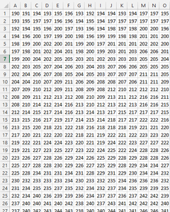

Step 8: Data Synthesis
When collecting the raw data, the variation in the start speed of the wheel will cause variation between the data sets. To help reduce the effect of such variation, we can truncate the data to fit within a specific range. For my purposes, I discarded values outside the range [190, 1000]. To do this, I would include a simple if-then statement in the formula bar which would take the value of a certain cell and copy it if it were within the desired range and would take no action otherwise. For the first cell of the data set, this statement would look like:
=IF(AND(A1>189, A1<1001), A1, "")
This could then be extended to all the other cells in the spreadsheet.
After filtering the data, I would copy it into a new sheet. Then, I would align the columns of data according to the final recorded time interval (so that all of the final recorded time intervals were on the same row). Lastly, I would discard certain start velocities to even out all of the data sets (so that all of the first recorded time intervals would be on the same row and all of the data sets would have the same number of data points). At this point, the format of the data should resemble the format of the data in the picture above. If you were to graph one of the trials with the time interval on the y-axis against the order in which the data point was recorded on the x-axis, you should get a curve similar to the one pictured. However, we need a way to average the data from the trials so that the levels can be compared against each other.

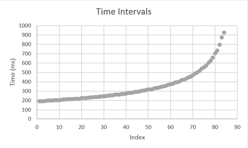

Step 9: Converting to Angular Velocity and Average Angular Acceleration
As mentioned, it will be helpful to convert the time intervals into angular velocity and then average angular acceleration. Note that velocity is given by Δθ/Δt and that angular acceleration is given by (Δθ/Δt)/Δt. Since each impulse represents the time taken for the wheel to rotate 2π/3 radians, the average angular velocity, ω, equals 2π/3s where s is the time interval in milliseconds. To calculate the average angular acceleration, α, (deceleration in this case), we need to only consider the first and final data points. Thus, α = ((ω_f) - (ω_1)) / T where T=C - s or the cumulative total minus the first impulse and ω_f is the final angular velocity and ω_1 is the initial angular velocity (this formula is pictured above). The final result should be multiplied by 100000 to yield an answer in seconds rather than milliseconds. This formula can be applied to each cell the same way the data was filtered by the if-then statement. For the first column of a given data set in excel, this is what I would include in the formula bar:
=(((2000*PI())/(3*A84))-((2000*PI())/(3*A1)))/((SUM(A1:A84)*0.001)-A1*0.001)
This would then be applied to every other column (note that A84 is the last cell of data in my case, but it will vary from data set to data set, and A will change depending on the column). Once the average angular acceleration for each data set is calculated, the fifteen resulting values can be averaged to yield a single, all-inclusive value for that specific level. These values can be graphed as a bar graph similar to the one included. Notice the trend in the heights of the bars. This suggests that there is a direct relationship between the voltage supplied to the solenoid and the corresponding braking force; however, there is not enough evidence to draw any conclusions regarding statistical significance. Inferential statistics come in handy at this point in order to allow us to make the desired conclusions.

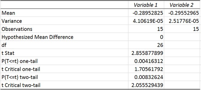

Step 12: T Tests
The ANOVA statistically proved the existence of nonrandom variation within the recorded data, but it did not identify the location of the variation (i.e. which data sets were statistically different; from the ANOVA we only know that there are at least two sets which are statistically different). In order to be thorough in the data analysis, it should be shown that every data set is statistically different from the other data sets. Ideally, this would be accomplished using Tukey's Post Hoc test which avoids the accumulation of errors resulting from a series of t tests, but Excel does not support this test, so we will use t tests. The error that does accumulate is negligible in this case. Here are the steps to complete a t test in excel:
1) Highlight two sets of data you would like to test
2) Go to the data tab
3) Select Data Analysis
4) Select "t-Test: Two-Sample Assuming Unequal Variances"
5) Click OK
6) For input range 1, select one of the sets of data, select the other set for range 2
7) The alpha value should be 0.05
8) If desired, choose an output area
9) Select OK
These tests should be performed with each possible combination of two data sets (i.e. control vs level 1, control vs level 2, etc.). If each p value is less than or equal to 0.05, the null hypothesis can be rejected for the totality of the project. Note that a two sample t test assuming unequal variances was used because there were two different data sets (two samples) and we do not know the variance (so we assume it is unequal).
Interpreting Results
To interpret the results, it is first necessary to understand the difference between one tail and two tailed t statistics. You can think of a normal distribution or bell curve as having two "tails" extending infinitely in both left and right directions. The one tailed t statistic considers the probability that the true population mean will exist within 5% percent of the total area under the curve in either extreme (in other words, 5% of the right tail or 5% of the left tail). The two tailed t statistic splits the 5% into 2.5% and considers both extremes (or tails) of the bell curve. By selecting the two tailed t statistic, we can increase our confidence with the conclusions. Now, consider the given t critical two tale value, denoted t_C and the actual t statistic, denoted t. If - t_C < t < t_C, then we accept the null hypothesis. In the case pictured above, the t statistic is outside this range. Therefore, we can reject the null hypothesis for these two sets of data.
Lastly, the p value is denoted "P(T<=t) two-tail" in the Excel output. Notice that in this case, p is much less than 0.05. The p values from the various tests are summarized in the table. Notice that the p values are larger for voltages close in value (i.e. level 1 and level 2, level 3 and level 2, etc.) and smaller for voltages farther in vale. This corresponds to the hypothesis that there exists a positive correlation between the voltage and the braking force produced by the electromagnet.

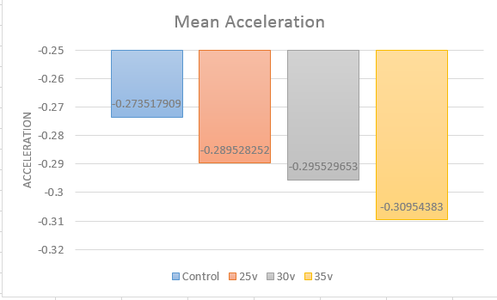

Step 13: Conclusion
In conclusion, the original objective was satisfied, and we know now that eddy currents can, in fact, be used with a standard bicycle wheel to produce a retarding force. Moreover, we know that with increasing voltage, the magnitude of the braking force can be increased. As follows, this system could plausibly be implemented onto a bicycle given a battery for the power supply and a sufficiently large electromagnet. There are also many other projects that could be started as continuations of this one. I will leave up to the reader to determine the next step in this instructable.
