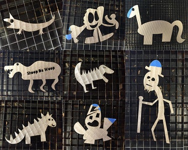

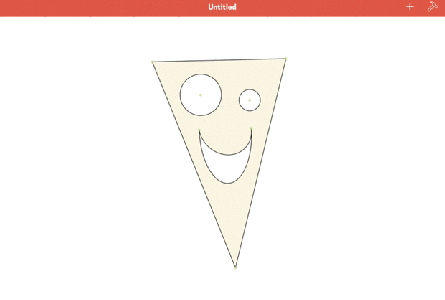

The goal of this workshop is to have students create a Monster or Designosaurus as a way to learn the sketching tools in Zotebook.
Then you can use the cutting tools to cut everything out by the end of class.
I like to call the Zote Monsters "Designosaurus," to emphasize the design aspects of the project.

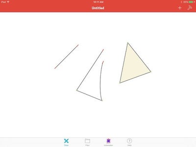

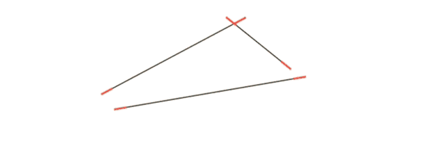

  • See how unconnected shapes are not shaded? These won't cut. Use "Join lines" to connect.
  • Notice the difference between wet and dry ink. Wait for the ink to dry or tap to make it dry quicker. Zotebook gestures only work with dry ink.
  • Erase is important, a simple circle/scribble gesture works well.

  • Zooming in can often solve problems, especially if lines aren't joining. Just use two fingers to pan.

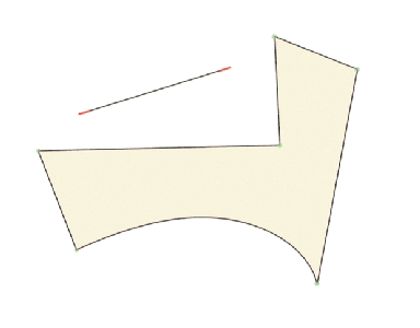

Step 9: Make Sure Your Shape Is Connected
If the area you want to cut out isn't shaded, it might not cut.

Check that the design is:
  • Connected (the shapes are all shaded in)

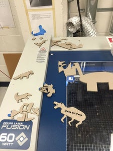

Step 14: Get Printing!
Some kids will have a Designosaurus ready to cut after about 10 minutes, others may want to take 45 minutes. We have found this is actually helpful since it helps us space out the cutting.
As designs become ready, make cut files and print when you have enough to fill a sheet.
