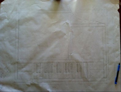

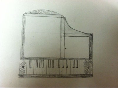

The first step is to plan the dimensions and design of your shelf. The person I built this shelf for will be going to college next year, so I built the shelf to sit nicely on your average dorm desk and also hold your average college textbook. First I drew a rough sketch of how it would look upon completion. From there I decided on what dimensions I would use. The bookshelf I built was two feet wide, roughly 22 inches tall, and 11 and a quarter inches deep. Depending on where you want your bookshelf to sit, you may want to change these dimensions to something more to your liking. After deciding on dimensions I drew a full scale plan so I could see what the finished product would look like. It probably isn't necessary to draw the life size plan, especially if you don't just happen to have a 2*2 foot piece of paper lying around, but for me it was very helpful. If you compare my drawing to the final completed shelf I extended the keyboard (which doubles as a drawer) there by shortening the pieces on the sides ( which open and double as small storage compartments.) After spending hours drawing it was time to make a list of what supplies would be needed to complete the project, which leads us to...

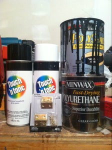

    • For the drawer behind the keyboard I used 1/2*4 inch oak. You'll need roughly 5 feet of board for the drawers, this will depend on how big you make them compared to how big you made mine.
    • Quater inch plywood is used for the back of the bookshelf and the bottom of the drawer.
  • Stain and varnish
    • I used a black gloss stain and varnish combo for the outside and clear gloss polyurethane for the inside.
  • Drawer sliders
    • I used 10 inch full extension ball bearing drawer sliders, but there are many other kinds you could use.
  • Small hinges (for the doors on the side of the keyboard, if you choose to install them)
  • Black and white paint for the keyboard
  • Wood putty. If you're a better craftsman than me you may not need any, but I personally made more than a few mistakes and used almost a whole container to fix them all. wood putty is my hero!

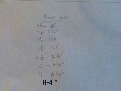

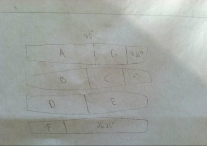

The next step is to cut all the boards to size. I used a table saw to do this because my radial arm saw choose a very bad time to stop working. If you have a radial arm saw or any saw that can cut the width of the boards other than a table saw I recommend using it. The table saw led to a few uneven cuts. Above is the length that each piece should be. All boards should have an actual thickness of 3/4 and width of 11 and 1/4, except for boards E, D, and the H's. Those boards need to be a 1/4 less wide ( so 3/4 by 11 ) in order for the plywood back to be flush.

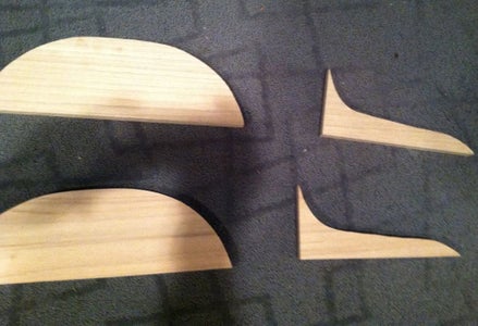

In order to give the bookshelf the curvy look of a real grand piano I decided to place boards at the front and back of the shelf. This leaves the middle open and available for storing thing or the perfect place for a desk lamp. To make a pattern to cut these boards I went on my computer, found a picture of a grand piano from above, then edited the picture until it fit the dimensions of my bookshelf. It would also be fairly easy to simply draw the curves if you have more artistic talent than I do. Once you have your pattern, cut the pieces out. I used a jigsaw to cut mine, but a band saw or even a scroll saw should all work fine. Once the pieces are cut out you can attach them to bookshelf. To attach mine I countersunk two holes for each piece on the inside of the bookshelf. These holes can be plugged later or left alone since they are hard to see anyway. Alone with the screws I recommend glueing the pieces in place. Another option would be to cut multiple ( 10 to 11 ) boards into an inch or so thick curve and glue those together. Doing so would give you an open compartment rounded on top instead of a flat space like I have. After this step your bookshelf will actually start looking something like a grand piano!

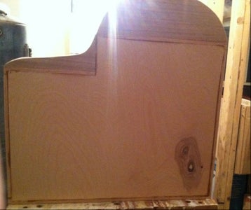

You could leave your bookshelf open, but I think putting a back on the shelf improves the look. To do this you will need to router a groove all along the inside edges of the outside boards on the back. The groove should be a quarter inch deep, the same size as the gap between the boards on the interior you cut shorter than the rest. Depending on what type of bit you use, you might ( like me ) run into a slight problem where your router wont reach far enough. To fix this I switched to a straight bit and just freehanded the groove. This step is basically why I needed so much wood filler. Once you router your grooves, measure and cut your 1/4 plywood to fit. I used a jig saw to cut the wood. Test fit the back, if it fits, good job! If it doesn't you may need to either router and expand your grooves or cut your back piece again. Once you get the back to fit into the bookshelf, get some glue and attach that thing! Along with glue I used finishing nails and an air nailer to secure the back, but I feel as long as you put some weight on the plywood to clamp it while the glue dries the nails are an unnecessary pain.

When I built this bookshelf I didn't want the keyboard to cover the entire front of the bookshelf, which left two small almost two inch spaces on either side of the drawer. I decided to put small doors over these small gaps so they could be used to house letters, pens, stacks of cash, or other small things. To do this I routered four grooves, two on each side of the drawer. You will want to router to the size of your hinge so that it fits flush, in order for the door to close completely. The door should be cut to cover up to where the drawer will sit. Make sure you measure precisely so your routered grooves match up with where you install the hinge onto the door. If everything does not line up your door may not shut all the way or it may hang crooked. I installed the hinges onto the doors and from there screwed them in place in the grooves. If the doors do not seem to sit correctly you can take the hinges off and try cutting the grooves a bit larger.

Whoa Whoa, hold your horses cowboy. Before you actually begin staining or varnishing your project make sure you sand the entire bookshelf smooth and fill in whatever cracks or dings you may have made with your wood putty. Following sanding clean off all the dust. Now you can begin to varnish. I varnished my project in two steps. First I put the black coat on the outside, then I put a clear gloss coat on the inside. Before varnishing the outside tape everywhere you don't want black (such as all around the inside). The less of a Picasso you are with a paintbrush, the more tape you're going to want to use. Once you're through taping you can finally start varnishing. I put on two coats of black gloss stain/varnish and it looked very nice! When the black outside varnish was dry I set the bookshelf on the back and put one coat of black on the bottom and one coat of clear on the inside. If you have more time you may want two or more coats on the inside, but because of time restraints I had to settle for one. It still looks very nice!
