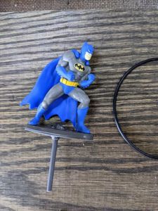

Step 2: Pulley
For the pulley system moving the prop, first gauge the span needed between the gears, so the belt is taunt. This is imperative for providing fluid movement. The belt, gear, and plastic supports can then be assembled with metal rods. One of the rods will be used to manually operate the prop so make sure it's long enough to be accessible behind the backplate. A hole will be needed to allow the operating rod to protrude.
Next, two 1’’ sticks of balsa wood need to be glued to the plastic supports in order to suspend the gears. To secure the pulley system to the frame, ensure it’s lined up under the ½’’ gap in the middle stage. Then the balsa sticks can be glued into place. Finally, attach a clamp the top portion of the belt that fastens to the prop. The prop can then be placed atop the gap and fastened to the clamp on the belt.

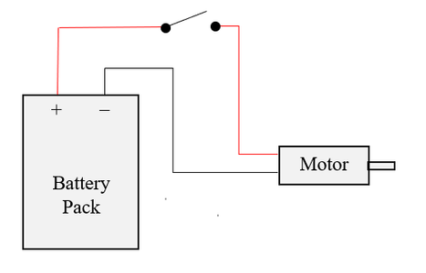

Step 3: Electronics
First collect all materials shown in the first picture. This
includes: a switch, a battery bank, a red wire, a circular motor attachment, and lastly the 5RPM motor.
Then, place a dab of hot glue within the circular motor attachment’s column and insert the motor.
Next, cut the tips off of all wires, then strip about a half inch of wire coating off. Proceed to twist the ends of the wire.
After that, insert one of the ends of the standalone red wire into one of the switch legs. Once through the whole, pull tightly through the hole and bend the exposed section around the hole. Take the excess exposed wire and begin to twist it around the switch end.
Then, repeat the process for all wires. Connect the other end of the standalone red wire to the one end of the motor. Then connect the red wire from the battery pack to the other end of the switch. Lastly connect the black wire from the battery pack to the other end of the motor. NOTE: When wiring the battery pack, not batteries should be in it and the metal lever should be oriented up.
Once fully wired as scene in the picture. Test the circuit by placing down the metal lever and switching the switch on.
Lastly, cut holes in the back of the bottom of the frame to feed the motor and switch through while keeping the battery pack inside. Mount the switch into place with hot glue.

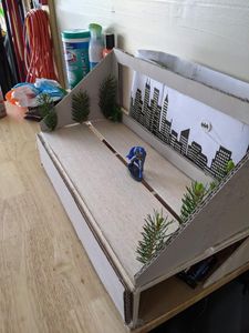

Step 5: Final Assembly and Aesthetics
For this step, you will construct the final assembly and implement any decorations or scenery that are applicable to your play. After the motors for the rotating background are mounted and the background is attached to the aluminum cans you can hot glue the backplate to the stage, leaving enough room for the background to rotate freely. We gave a 2 ½” gap from the back of the stage but depending on mounting this could vary slightly. For our project, we used bits of pine trees as scenery that were hot glued directly to the stage, but feel free to use any scenery or décor that would fit the theme of your play. Just make sure that any scenery doesn’t interfere with the prop’s movement. Finally, we cut out a 16” x 3 ½“ piece of cardboard that was spray painted to the same color as the backplate and glued it to the front of the stage for clean presentation.
