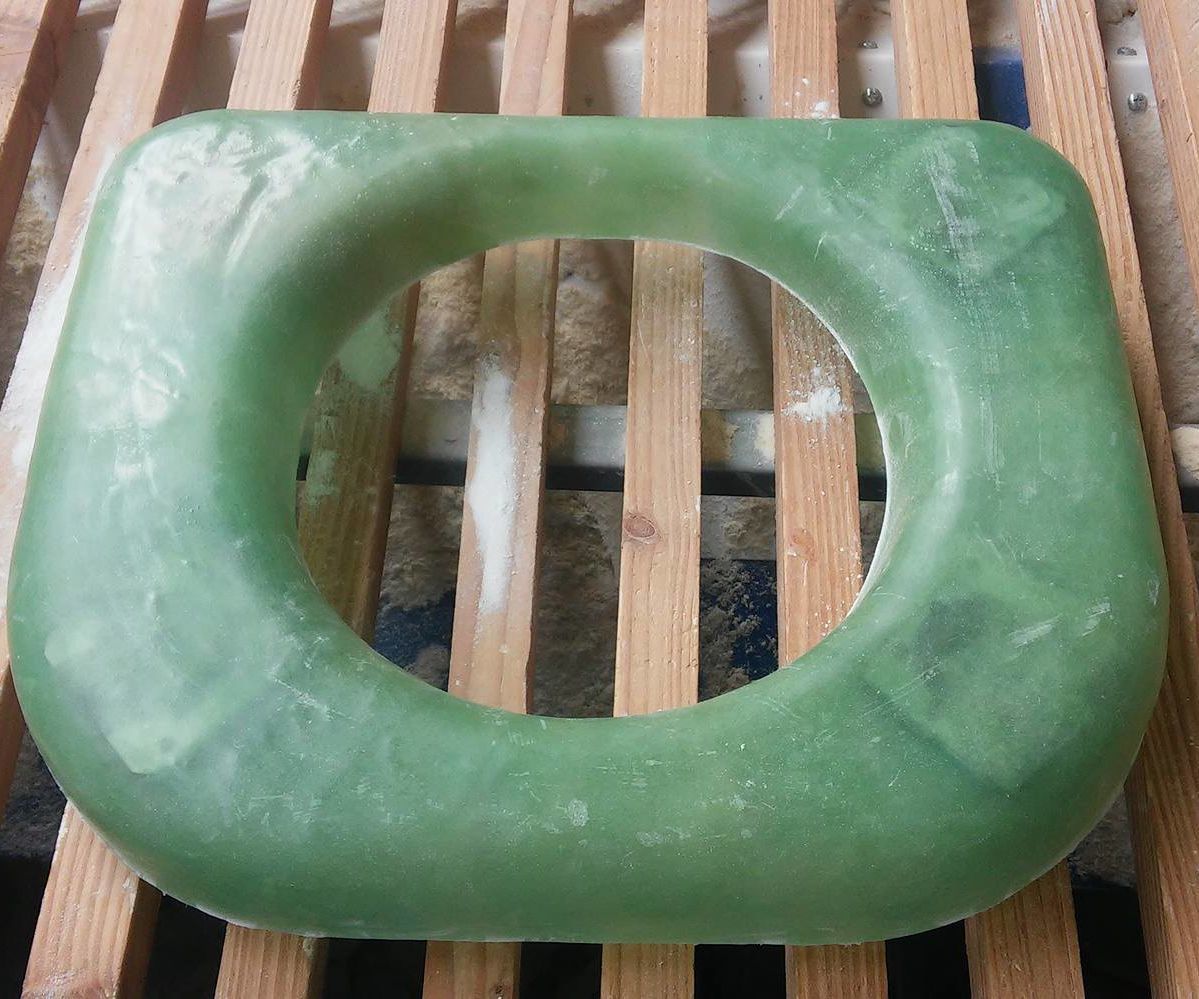

Step 10: Magnets
Now it's time to take the fiberglass seating that we made previously Hand lay-up toilet seat and finish it for the final product.
Glue with Superglue the magnet inside four metal pieces, which would be already incorporated in the seating, adding previously a piece of wood in the inside of the tube, so the magnet won’t go dipper. Make sure that the magnet that you buy fits perfectly inside the metal tubes. Be careful with this step, because the magnets are very strong and it’s difficult to place it in the right place. You can help yourself with a hammer.
Step 11: Reinforce Metal Pieces
In this point, we realized that there was a little bit of looseness between the legs and the metal pieces, so the seating wasn’t enough stable. To fix this, we added some fiberglass with resin around the metal tubes, covering it completely, and when it was dry we sand it with the sandpaper. If your legs fits perfectly with the metal pieces, you can go to the next step.
You can see the process of working with the fiberglass in our Instructable Hand lay-up toilet seat.
