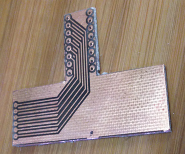

Step 1:
Double sided PCB.

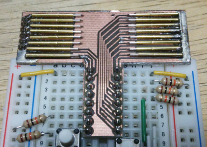

Step 2:
These are the Pogo Pins.
They will be solderd on the PCB.
Step 3:
Pogo Pins and pin headers are soldered.
The Detouchable Converter Board set on a breadboard need only the space as 16pins DIP.

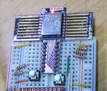

Step 4:
ESP-07 is mounted on the board and can be unmounted easily.
Step 5:
ESP-12 can be also mounted.
