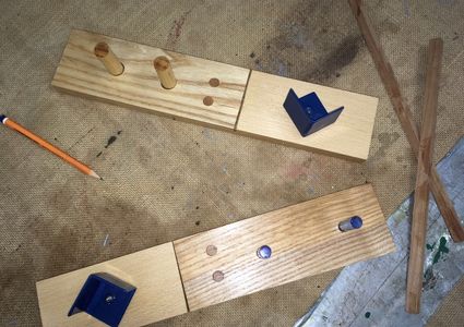

Step 7: Making the The Wood Base
Welcome to the second part of your Coat hook, you are nearing the finished final product now. In this part you will be learning how to build the base on which you will place your wooden dowels and coat hooks previously made. To make the base you will be using two different types of wood to create a lap joint. A lap joint is a very strong joint created by taking an equal amount of wood away from each piece of wood.
STEP 1
For this step you will need:
  • Two pieces of wood
  • `A Tenon saw
  • A Tri Square
  • A steel rule
  • A marking gage
  • A Band saw
  • A pencil
  • Disc Sander
  • A Chisel
  • A Wooden Mallet
  • PVA Glue
  • A G Clamp
STEP 2
First of all what you will need to do is you will need to find the half way point of one of your pieces of wood using your steel rule, to draw the line, line up your tri square to create a perfect 180 degree line square with the edge of your wood and draw a line against it. Use your pencil to draw 'waste lines' on one of the halves. Do the opposite side on the other piece of wood.
STEP 3
Next you must measure the width of the edge of one of your pieces of wood with your steel rule and set your marking gage to half of that measurement. If your marking gage is slightly off the measure meant you may tap it on your workshop bench, on it's head to shorten the measurement, on the bottom to increase the measurement. Once set perfectly lean the needle against the edge of the piece of wood and lock the piece in the wood. Use the needle in a leaning dragging down motion to create a scratch down the middle. Stop when you reach in line with the pencil line you created earlier. Use your pencil to draw waste lines along this new piece. Do the same on the other piece of wood.
STEP 4
Now you must use your tenon saw to saw along the most shallow line along the face of the wood. Saw down to half way where you drew a line earlier. The correct motion for using a tenon saw is to keep your arm square while holding the saw pointing your index finger forward. Do the same on the other piece of wood.
STEP 5
Now you must use your band saw to cut the deep line on the edge. Lock in the gage at the correct measurements according to your piece of wood. Use your left hand to press the wood against the vice and your right hand to slow push the end of the wood towards the band saw. Turn it on and keep pushing till it reaches the end. Make sure to set the machine to the right level (on our machine the power was on '2'), do the same on the other piece of wood.
STEP 6
Line your pieces of wood up against each other to see if they slot and fit in well. If there is a gap where they won't fit together you must use a disc sander to sand down the ends to the measurements they need to be shortened by. If needed use a chisel and wooden mallet while clamping down your pieces with the G clamp. Chisel off the pieces necessary. Do the same on the other piece of wood.
STEP 7
Use PVA Glue on one side of one of the lap joints and joint them together like a jigsaw. Clamp it with a G clamp and wait for it to set. Clean up the sides where glue may have seeped through with a damp paper towel.

Step 10: Cutting the Wooden Pegs
For this step we will be adding finishing touches to finish our project. We will be adding on the pegs and screwing on our diamond coat hook previously made.
STEP 1
  • For this step we will need
  • A steel rule
  • A tri square
  • A long wooden cylinder (or other material you wish to make pegs out of)
  • Danish finishing oil
  • Paper towels
  • A pencil
  • An electric screwdriver
  • Screws
  • A Band saw
  • PVA Glue
  • Sand Paper
  • Sanding block
  • Danish Oil
  • Paper
STEP 2
For this step we will be using the band saw to cut our wooden cylinder using the same technique as we used to cut our wood pieces. Set the guard to the correct measurement as this will determine what size your peg will come out and place pressure against the vice and using your left hand to clamp it and your right hand to push it forward to cut it.
STEP 3
Using the same technique as you used in the last step involving Danish oil and paper towels to apply two layers of the oil to finish the pegs. Place some PVA glue in the freshly drilled holes and once dried place the pegs in and allow them to dry until secure making sure no glues pills onto the face of the wood and that it stays in the hole.
STEP 4
On the smaller side find the halfway point of the length of your wooden piece using your steel rule to measure and your tri square and pencil to draw in the lines, do the same across the way and find where the two lines intercept. It should be in the very centre on the smaller side. Using your pencil draw a small X mark where it intersects if correct. Get rid of the rest of the pencil lines by sanding then reo-iling and drying or perhaps rubber depending on how efficient it appears on the wood.
STEP 5
Using your electoral screwdriver, screws and diamond shaped hook place the screw through the hook and using the electric screw driver drill in a piolet hole using a small drill bit, then screw down the hook using an electric screw driver using the correct size screws square onto the X mark created on the smaller side.
STEP 6
Make sure the screw is tightened fully and that the pegs are dried fully before cleaning up the face of the wood and making sure there are no glue or pencil markings on the face of it. Using your sanding block and paper sand along the gran avoiding the metal coat hook.
STEP 7
Using your Danish oil and paper towels and the same technique earlier used oil it back up and let it dry.
STEP 8
Enjoy your new coat hook!
