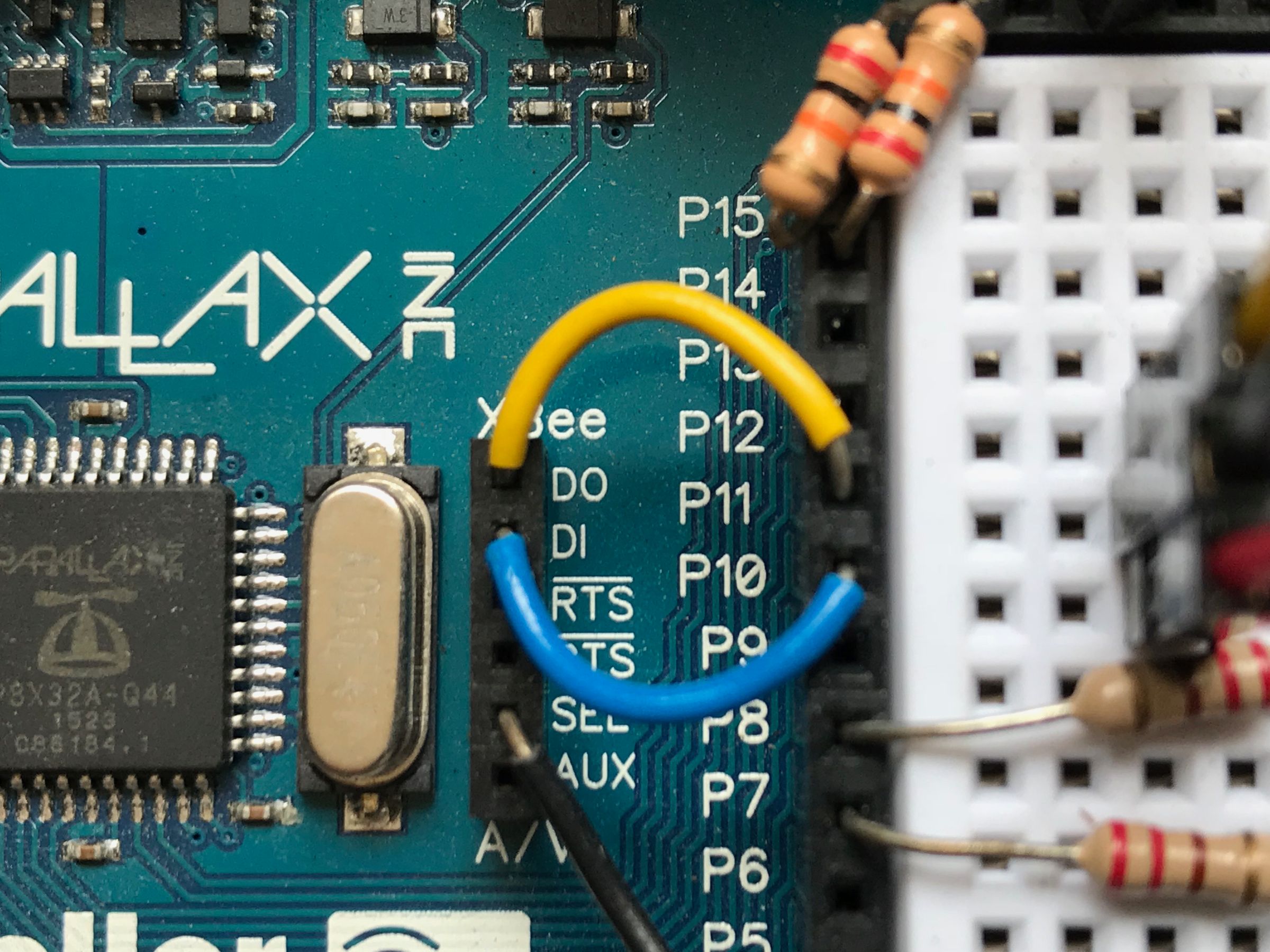

4. Wire for wireless--using two jumper wires, connect the XBee headers to the Propeller microcontroller:
- Use one wire to connect XBee DO to P11
- Use the other wire to connect XBee DI to P10
Parallax also has clear wiring instructions, but be sure to use the pin numbers as listed above

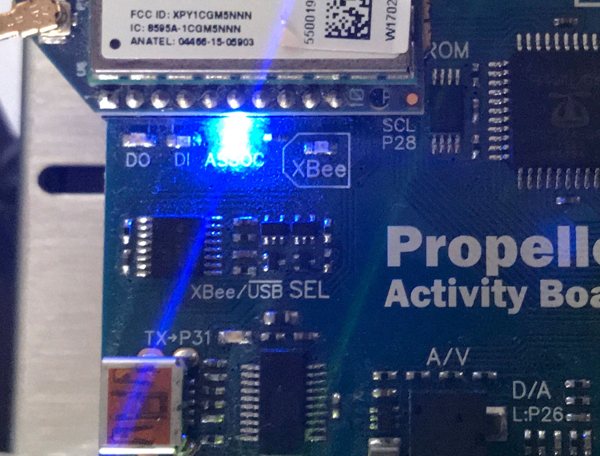

- Set the power switch to the "1" position to power the board and XBee3 Cellular.
- Wait for the blue ASSOC light to blink, indicating a connection to the cellular network:
- Set the power switch to the "2" position, and press the RST button above it.
- Check your mobile phone for a text message: "Robot 1.2 ready..."
