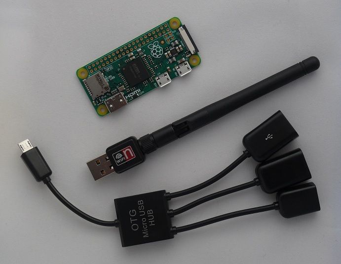

For simplicity and size I have used a Pi Zero here but any of the Pi’s should work. I could have used a ZeroW (WiFi) but for the same cost one can get a Zero plus a 2 port USB hub and use a WiFi dongle to optimise the aerial location.

- Pi (any)
- SD card(suggest 8GB or greater)
- USB hub
- Wifi Dongle
- Monitor and leads
- Mouse (for setup)

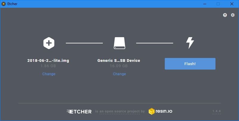

Unzip the file to a known location. Then run Etcher to download the image to an SD card. Etcher is free and downloadable from https://etcher.io/ and is straightforward to run:
After the card has been flashed add a blank file called ‘SSH’ to ‘Boot’. This enables the Pi to be driven remotely and set up from a PC and also to take advantage of copy and paste of the text listed here.

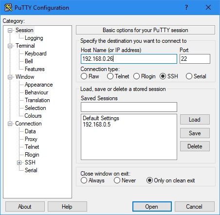

Power up the Pi. When it is running find the IP address by logging onto your router. Alternatively, if using the full version of stretch, this can be found by connecting a monitor, mouse and keyboard and click the internet icon at the top right of the desktop. On Stretch Lite (with monitor and keyboard connected) use the instruction sudo ifconfig and look under wlan0>inet addr: . I find the router option by far the easiest.

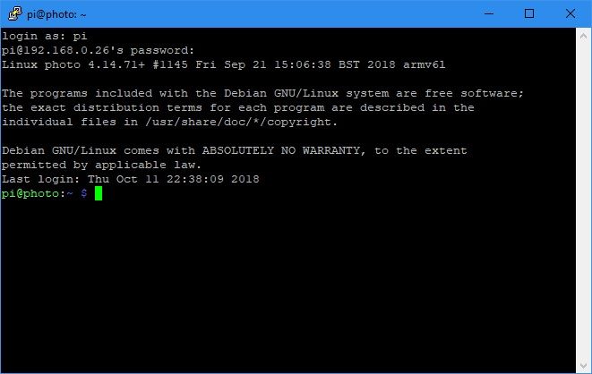

Run Putty (free download from https://www.chiark.greenend.org.uk/~sgtatham/putty/latest.html ) from a PC and enter the Pi’s IP address.
Log on as ‘pi’ with password ‘raspberry’.

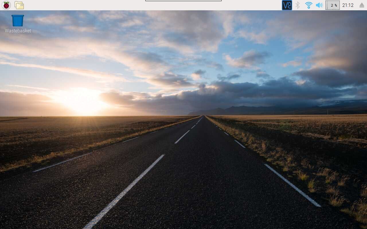

Now shutdown, connect the monitor and power up again. The Pi should boot into the desktop.

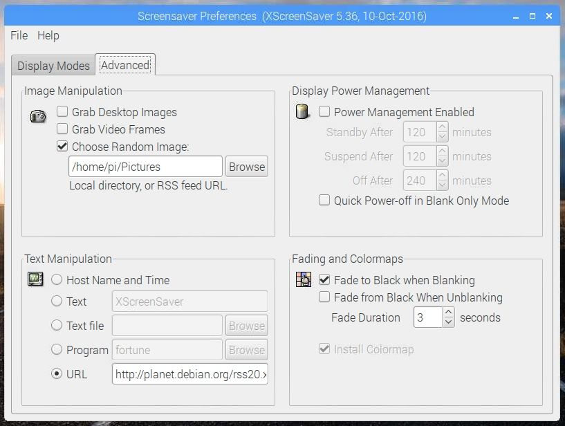

Then click the Advanced tab to tell xsceensaver where to get images. Under ‘Image Manipulation’ tick ‘Choose Random image’ and browse for the /home/pi/Pictures directory:

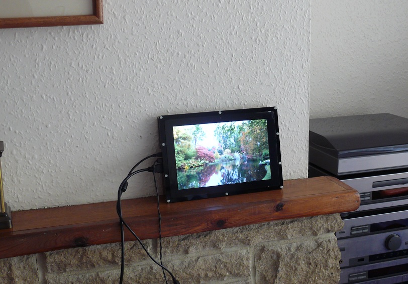

The 10" Waveshare monitor is nice - and larger than many commercial systems.
However the 22" iiyama is simply stunning.
It is time now to sit back and enjoy your photo slideshow.

I followed all your instructions cause i'm totally noob with raspberry but I had some problems with GLSlideshow (didn't show all pics, or got blank after 12 hours like all screensavers) but I've used a program called feh and made it boot at startup, and it works totally perfect, thank you very much again!
