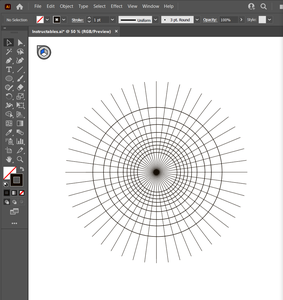

Making the Mandala grid -
In this design, the final mandala pattern is divided into 48 equal radial sections, and the piece is a 140mm dia circle.
  1. Start by drawing one line of length >14cm.
  2. Divide 360° by the number of sections to determine at what angles the line will repeat along the central axis.
  3. Here, 360°/48=7.5°. Hence, we need to copy and rotate this line at 7.5 degrees, 48 times (CTL+D).
  4. In Adobe Illustrator, select the line we created. Right click and select Transform>rotate.
  5. A new pop-up comes up, asking for the angle of rotation. Type 7.5 and press COPY (not 'OK').
  6. On pressing COPY, we can see that a copy of our initial line has been created, which is rotated at 15 degrees. To repeat this step multiple times, simply click CTRL+D to rotate-copy 15 degrees successively, or you can choose to repeat step 3-4.
  7. To create a mandala, we first need to plan a base guide grid of concentric circles which allows us to create our geometries, with repeating segments from center to outer.
  8. The outermost circle in this design is of diameter 140mm. For a base grid, we can divide into any number of concentric circles within this outer circle. Create successive inner circles of diameters 115mm, 100mm, 85mm, 74mm, 65mm, 58mm, 50mm, 42mm .
  9. Once we are ready with the grid, we can choose a grey stroke color for it and lock it using CTRL+2, so that it does not hinder with our mandala creation but acts as a base grid.

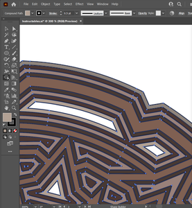

Step 2: Create Offsets to Form the Layers
Step two is pretty straightforward! - creating offsets of our created mandala pattern to form the successive layers to add to the depth.
For this, follow these steps -
  1. Select the shape, and go to Object>Transform>Path Offset and type 1mm (positive sign to make offsets on the outer side).
  2. Choose a different fill color (preferably a darker shade of the first layer to see it clearly). Select this new layer and press CTRL+[ to make this layer go behind the top one. Now you can see how the two layers superimpose.
  3. Repeat step 1 and 2 three more times for this design to get 4 successive layers in total.
  4. Next, we need to clear out the extra undesired offsets being formed outside of the first layer's 140mm dia circle. For this, select all the layers together and click on the Shape Builder tool (Shift+M). Now, while pressing the ALT key, drag or click on the undesired shapes outside of the outermost 140mm circle.
Separate these 6 layers and place them next to each other, then save it as .svg by going to File>Saveas and select .svg in 'save as type'. We can also export it as .dxf, .dwg or .pdf.
