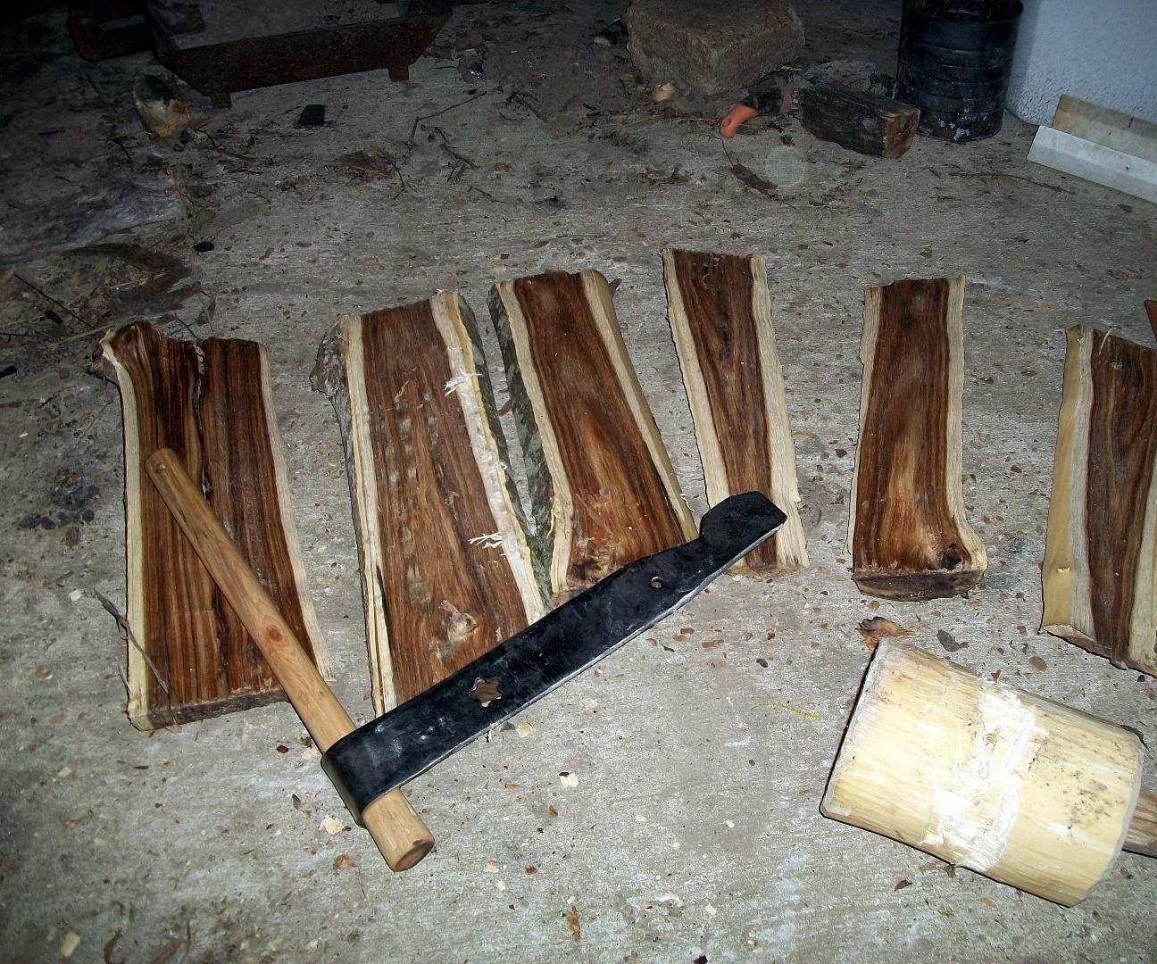

A battery operated chain saw, I could have used a regular saw, and so could you!
A Ka-Bar combat knife for splitting the wood, steel wedge and sledge, or a froe would also work. (this is part of a forge building adventure so I can make a froe out of an old lawnmower blade)
A piece of wood to drive the knife (or froe if you have one)
Red oak for charring and burning

First I cut the red oak to slightly less than the length of the coffee can, then I split it till it was roughly 3/4" thick.
The thickness was somewhat arbitrary. Since I plan to use this in a forge soon, I thought I didn't want it too small, and since I was just experimenting and wasn't sure if this would work, I wanted as much surface area as possible.
I then filled the can as much as I could, and covered it with aluminum foil. I put a small hole in the aluminum foil to allow moisture, and eventually wood gas, to escape.
