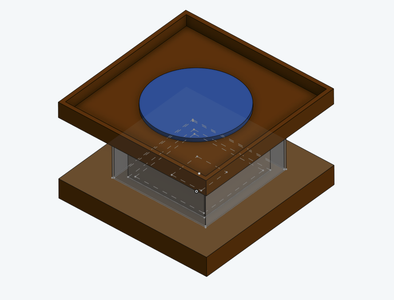

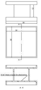

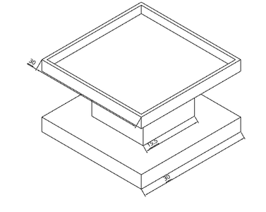

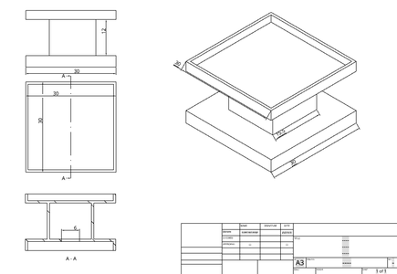

Step 1: Woodwork
The basic table shape was created using ¾” MDF with the dimensions in the attached images
The MDF boards were cut at the shop and joined using wood glue and screws.
DO NOT join the top portion right now, as you will need to install the electronics and other parts before installing the top. Drill a hole in the center of the top portion for wires to come up.

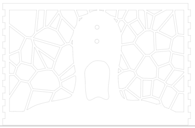

Step 2: Laser Cutting
For the disc and the jali background behind the elephants, 6mm MDF was cut using a laser cutter.
The disworld map was traced and edited from the scanned images by reddit user Tooko1005 [https://www.reddit.com/r/discworld/comments/pofwmn/super_high_resolution_discworld_mapp_for_your/] using InkScape
The attached SVG files have the patterns. Black is for cutting out, Red is a 0.15mm engraving, and Blue is a 0.1mm engraving. The first 2 sheets can simply be cut, but the disc is far more complex, requiring both cutting and glueing the continents onto their pre-engraved places.
The Jali consists of 4 panels lasercut in MDF (please note, the 4 panels have slightly different patterns so that they can mesh together, so DO NOT cut one pattern 4 times). The pattern was cut using Luban3D software

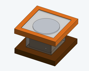

Step 8: Final Assembly
  1. Glue 12V Warm White LEDs under the top portion (this would highlight the elephants and the turtle).
  2. Screw and Glue the Top, snaking the power and LED wires through the hole.
  3. Snake cables through the hole in the mirror and place mirror on the top
  4. Connect cables to the ESP32 Electronics
  5. Place the Discworld in the center
  6. Prepare the glass sheet with 2-way mirror sheet. Cut a 17.5” dia circle in the center of the 2-way mirror sheet (be careful with measurements here – we ended up with the cutout off-center). Place the glass sheet on the Top
  7. Place the painted top cover ( ¼” MDF) to enclose the glass and electronics in a safe way
The mirror and 2-way mirror sheet create an infinity effect. Infinity mirrors use two-way mirrored film to create an effect of it infinitely extending endlessly inward, making it feel as if it is much deeper than it is.
