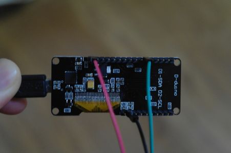

Step 2: Connect
Connect DHT11 sensor's RED,BLACK pin to D-duino's 5V and GND.
Connect DHT11 sensor's Green line to D-duino's D4 pin
