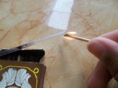

Step 2: First
- Take Pen ink cartridge and burn the end
- After that, insert the ink cartridge into the motor
- Next, cut 5cm the ink cartridge using the pliers

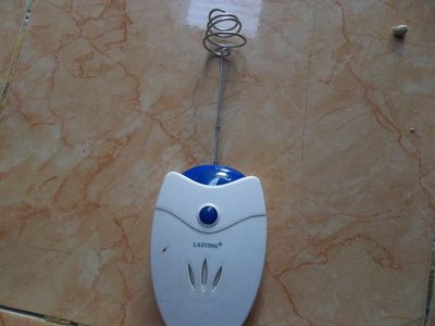

Step 3: Roll the Stainless Steel Wire
- Take the stainless steel wire and roll it
- Next, Take the end on the inside and pull it like image 2 and 3.
- Next.....
Step 4: Almost Finish
Take the motor and insert the wire into the motor like image 1.
After that, Take the case and insert the motors into the case. Make a simple circuit (Battery-switch-motors), and test it!!!
Step 5: Test It!!
How it works? look at the video.
