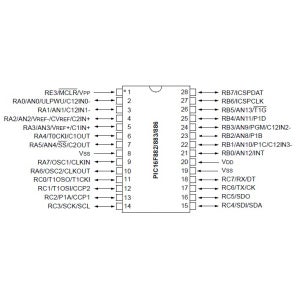

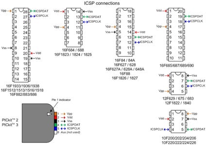

Step 8: Hardware Needed -pickit2 Programmer
you can buy any type of pickit2 programmer
if you are buying the one with zif socket then it is good !
it will reduce the time of connecting jumpers to the icsp pins !!
#connect the jumpers properly if you are using icsp to program the pic ic .

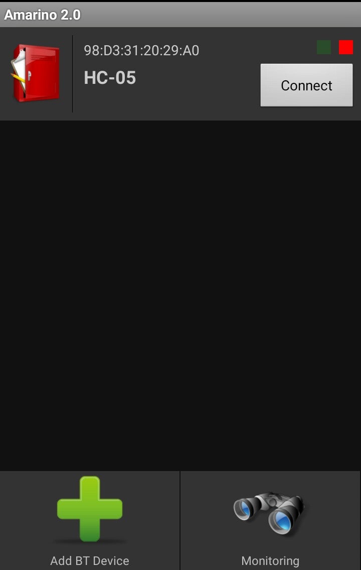

Step 13: Android App !
Download Amarino.apk at google play store !
Step 14: Commands to Control Led Lamp !!! Watch Video
send "a" to turn on the lamp
send "x" to turn off the lamp !
