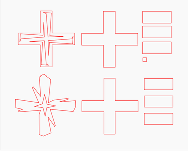

Step 1: Create the Files for Laser Cutting
The software that I personally used for this step is Inkscape, but any software that could do the same things should do the trick, too.
This step is where we will be creating our files for laser cutting the pieces needed for (1) the top circular portion of our lightstick, and (2) the different album design toppers.
The album design toppers not only consist of the design at the front, but also the cross back piece and the 3 connector pieces.
You could take a picture of the albums that you want to create toppers for and trace them using the Pen Tool, or you can make use of the Trace Bitmap tool instead. Personally, I prefer using the Pen Tool for simpler designs so I can edit the design as I please along the way, but for more complicated designs (such as 'Tomorrow', the orange one), then making use of the Trace Bitmap tool works best.
Make sure that the dimensions of your files are proportional to that of the size that you want your actual pieces to be. Personally, I made my toppers about 90mm long and wide, my connector pieces about 50mm in length and 20mm in width (when calculating for these, make sure to take into account the thickness of your acrylic sheets), my circle bases (for the top portion of the lightstick) 75mm in diameter, and the rectangular panels (for the top portion of the lightstick) 20mm in width and 40mm in height.
Here are the laser cutting files that I used for this step of the project:
Step 2: Laser Cutting
Once you have completed all the files for the top portion of your lightstick and the different album design toppers, then we can commence with the laser cutting.
The laser cutter that I used for this project is the ULS 3.6. This machine is set up so that it cuts through vectors that are 0.0001 inch thick and are red in color, so if your cutter has settings similar to this, make sure to take that into account when creating your files before moving onto the actual laser cutting.
I downloaded my Inkscape files as PDFs and then transferred them to the device connected to the laser cutter. Then, I placed the acrylic sheet with the color appropriate for the design I will be printing, adjusted the laser to avoid cutting outside the sheet, and then finally allowed the machine to start laser cutting. Note that this process may vary, depending on the model of your laser cutter.
Repeat this process until all your acrylic pieces have been laser cut.
