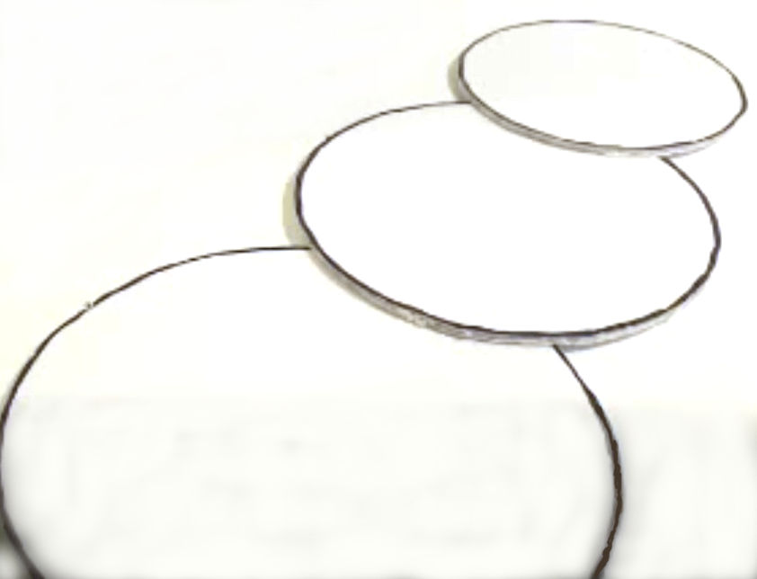

You will build the snowman out of a piece of foamboard. Use three plates of different sizes, or any round objects, that will give you a nicely proportioned snowman. Cut the pieces out and consider sanding the sides too.
Cut three Circles
Use a black marker to go around each circle, to make them stand out. And we’ve got the start of a snowman!
Snowman Body
