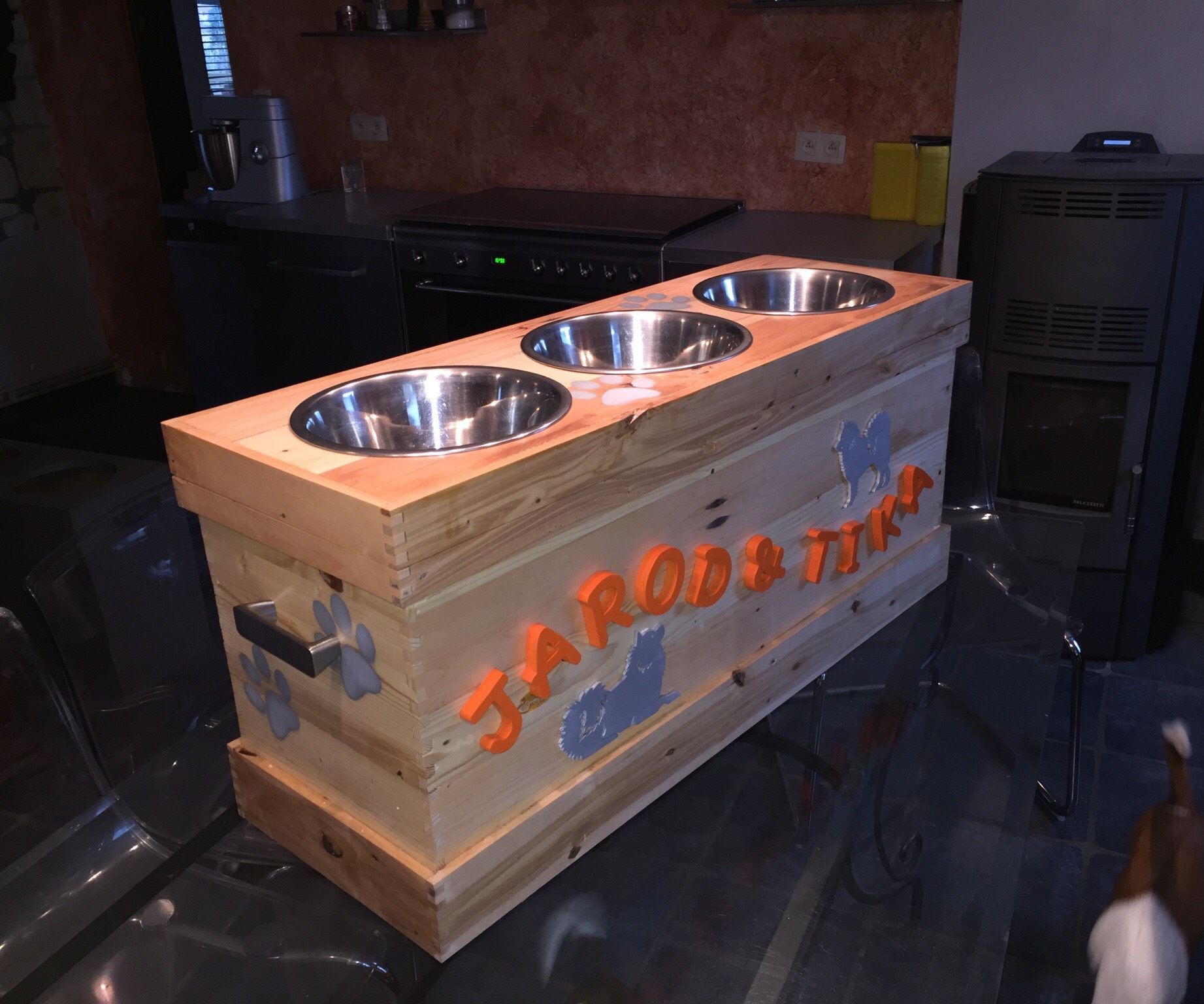

I made this table for a friend who has a very smallhouse and three giant dogs. she had problems finding the right place to feed them so I built a dog feeder coffee table out of reclamed wood.
I had an unfinished coffee table made of beech.
I also had a few pallets that I could use and scraps of other woods.

The body of the table is glued together with domino tenons. I wanted to use as few screws as possible because this will be used by dogs and I wanted as few metal as possible to avoid rust if in contact with liquids

Once all was done, four layers of varnish and the table is finished.
Step 7: Testing in Real Situation
I could then deliver the table to our friend and have a live test with her dogs
First impression?
APPROVED.
