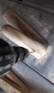

Step 10: Drill Holes
Drill a hole near the top and near the bottom. You'll want to have the top of the wall-side a bit higher than the hook so that it peeks above the hook when a coat, hat, or other object occupies the hook. As you'll also see in a bit, keeping the wall side higher than the hook allows you to display designs or other decoration.
Use a 1/8 bit or so for the main holes, then recess the hole slightly using a 5/16 inch or so bit.

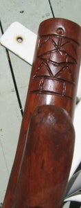

Step 12: Optional: Add Some Decoration
Here, I added a tribal decoration.
First, lightly sketch out your design, then use a Dremel tool to carve along the guide lines.
Be sure to re-sand over the decoration after using the Dremel tool. Fold the sand paper to get into the little design cracks. Canned air will help remove the sand dust from the cracks.
