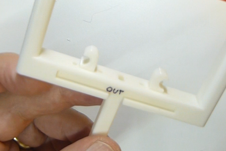

Step 1: Assemble the Shaft Into the Handle

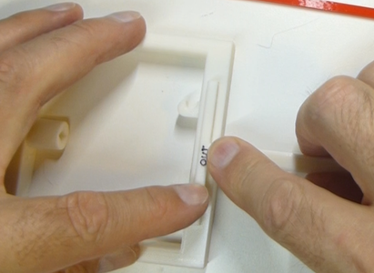

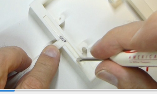

Locate the word OUT printed at the top of the T for Domino-pickupTool_285mm_pickup_shaft.stl. Insert it into the Domino-pickupTool_simple-handle.stl slot with the word OUT facing out. This should be a VERY snug fit. Once you push it in, take a small screw driver and push the SHAFT all the way into the handle. If it absolutely will not fit, sand some of the top of the T down until it does.
If you accidently insert it upside down and you cannot get it out, you may have to drill the rivet holes out a little. Also make sure the pushrod does not bind where it exists the T into the handle. I enlarged that hole to give it lots of clearance.

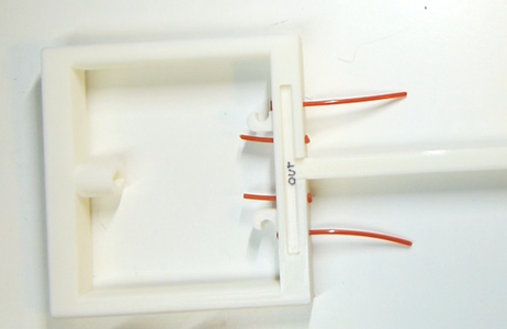

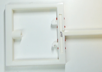

Step 2: Rivet the Shaft to the Handle

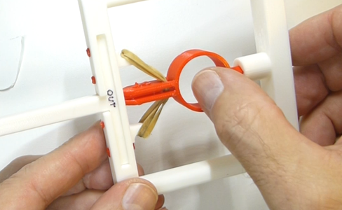

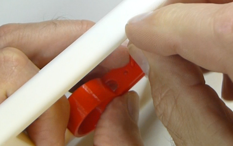

INSPECT your print. The ball at the end of the fingers should be well formed.
Install the Rivets to attach the handle to the shaft. Don't worry about any load. These are just to keep the shaft from slipping out. Follow the procedure for fashioning a rivet and securing it in place.
If any of the holes are close but too tight, by hand you can turn a small drill to loosen the hole. I use a 5/64th which is about 2mm.

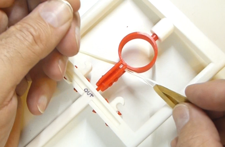

The "simple_plate" which is the Domino-pickupTool_simple_plate.stl and is actually the pull lever and it gets inserted into the handle.
PREPARE THE "simple_plate". Remove any support material from the diamond. Be sure to trim any bonded layer from the support material from the bottom of the diamond. You may have to slightly trim this a smoother movement.
Put the handle on a flat surface. Hold the "simple_plate" at an angle and insert the diamond into the hole. You can put a slight bot of lubricant on the plastic diamond to help avoid binding. I use "Super Lube" PTFE grease, but you can use something like vasoline. It only takes a thin thin amount.

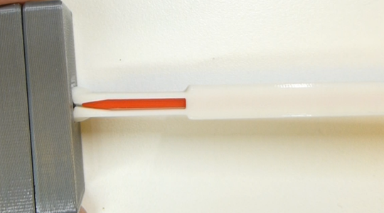

Inspect the "Domino-pickupTool_216mm_pushrod.stl." It should be even with no elephants foot. Inspect the holes, make sure there is no print debris on the shaft.
Observe the shaft is flat on one side and rounded on the other (the top of the print).
INSERT the "Domino-pickupTool_216mm_pushrod.stl" into the shaft end with the rounded edge facing the OUT on the shaft. It should reside between the tongs on the "simple_plate." The pushrod should move freely in and out.

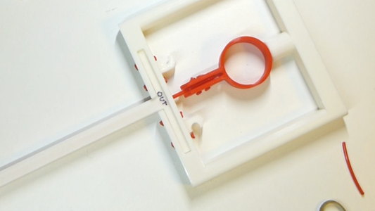

Align the pushrod holes with the "simple_plate" holes and insert some Filament Rivets. Before closing the rivets ensure you have free movement of the entire assembly up and down. Trim any binding ever so slightly until smooth if required.

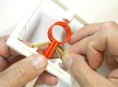

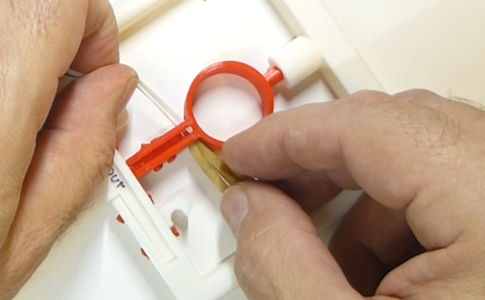

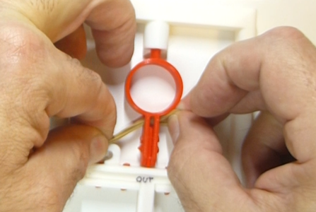

Step 4: Install the Rubberband
If you are using a folded rubberband:
- Insert both ends of the pull line through the hole at the base of the "simple plate"
- Fold the rubberband and insert it through the loop of the pull line
If you are using an unfolded rubberband
- Insert the pull line through the rubberband and insert both ends of the rubberband through the hole at the base of the "simple plate"
Attached the rubberband
- Pull the rubberband through the hole.
- Latch the rubberband around the first hook
- Stretch the rubberband around the handle second hook
- Test the movement of the pushrod.

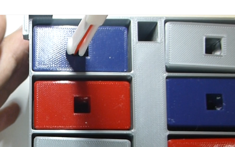

Step 5: Test Your Tool
Inspect the Shaft print
The shaft printed flat on the plat on the side opposite the side labelled OUT. The edges of the shaft are all cut at a 45% angle. Make sure there is no elephants foot or lingering support material. Trim as needed. It should match the quality of the edges on the top of the print.
Try it out.
- Depress the button by pulling it upward.
- Insert it into a domino hole and release the button.
- The domino should stay on the end.
I find it is faster to loose stack some dominos, then insert the tool down the center while roughly aligning the holes to the tool can engage. The tool will drop down through the dominos as you do that.
