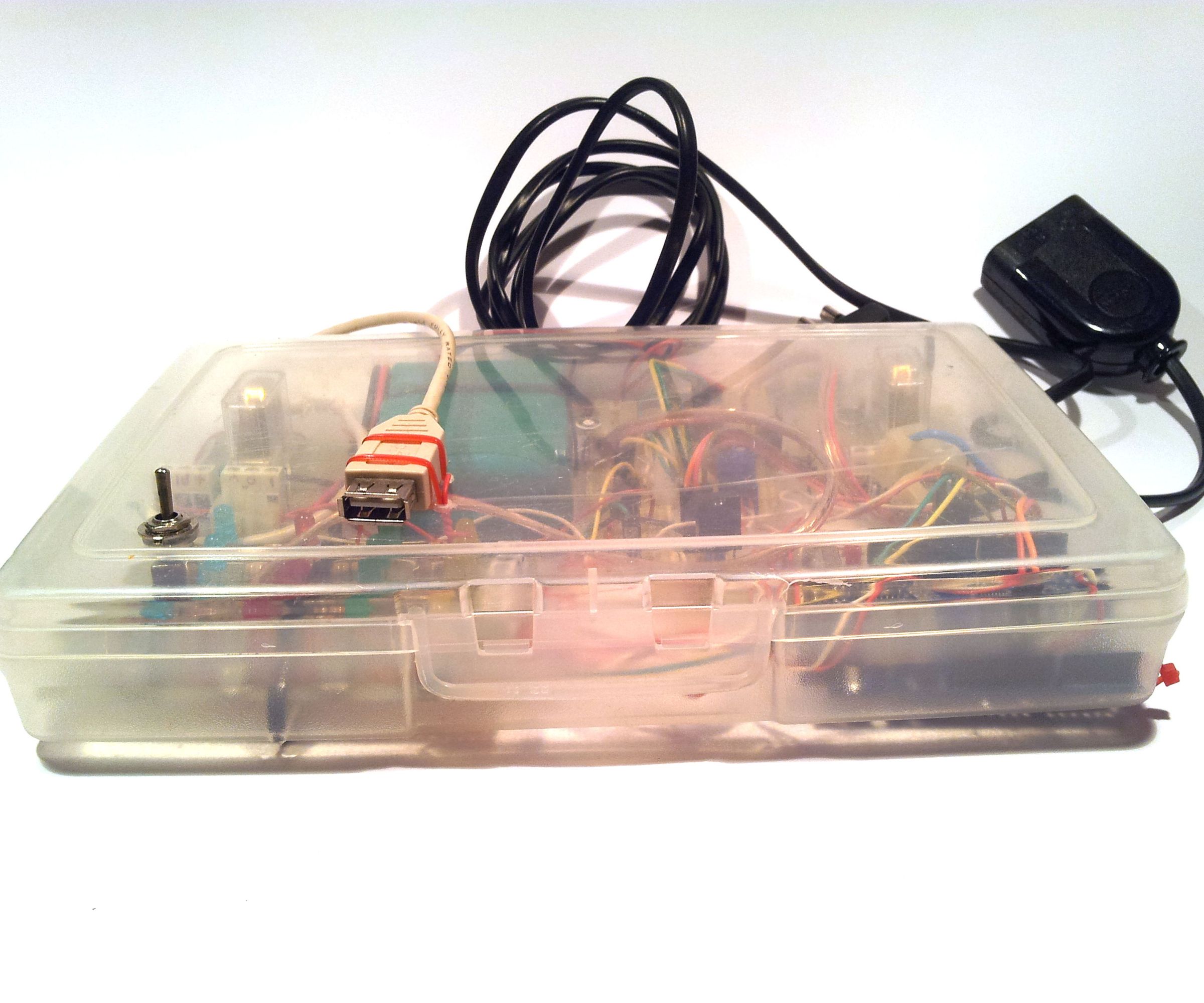

Introduction: Domotic Arduino
Feutures:
- Move the roller shutter when push the button
- Stop the roller shutter when it is completely open or closed
- Stop the roller shutter when push the button up while it's moving down
- Stop the roller shutter when push the button down while it's moving up
Operation principle
Arduino counts the holes on the roller shutter with the infrared receiver; the infrared diode is positioned on the other side of the roller shutter. When the hole is aligned with them, Arduino increment or decrement a counter to determinate the position of the roller shutter. To connect the actuators and the sensor to Arduino I used two LAN cables (see last step)
Step 1: Scheme
Step 2: Software
