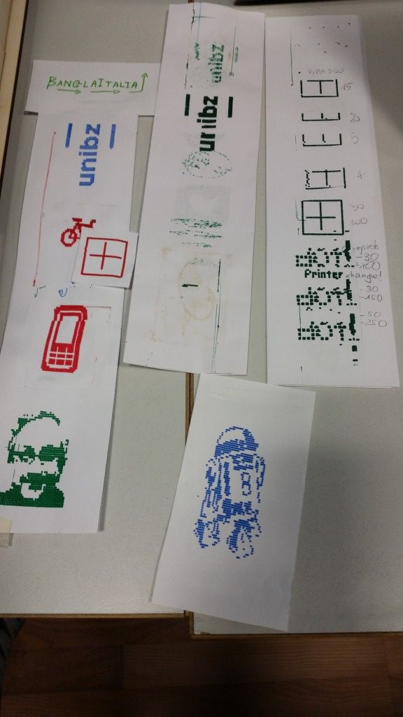

I know that these kind of projects don't always receive a "I made it", because of its degree of difficulty, so I tried to make mine easier.
This project was started more than a year ago, because of the lack of time i could only work in it while on college recess, but this is great because I finish it during the remix contest, that's fit perfectly in this case. If you think that I deserve your votes in the contests don't be shy and hit the button, I really like your support.;)
Update: Thanks to everybody that voted for me in the contests, you're awesome! I will make new instructables with these amazing prizes.
I also wanted to make this a motivation, I don't even dream of putting my hands in a laser cutter or 3D printer for making my projects, so I made this printer only using my dremel to cut the plastic pieces and gluing them together with super glue.
What can I say? It worked.

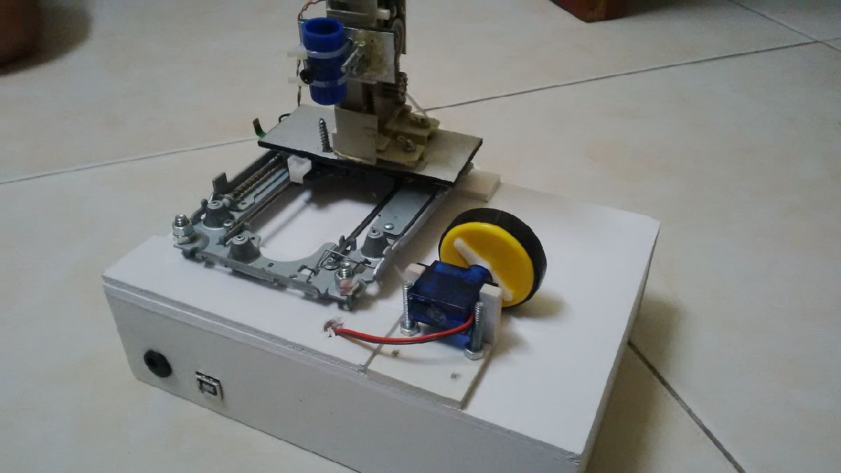

Step 1: The Motivation and My Ideas
Lets give a look in the Brunoip's version and compare with mine:
-It uses a Stepper motor to pull the paper, it makes the circuit and programming more complex, but the precision it's very reliable, I used instead a DC motor, making the circuit and programming easier, but losing a bit of the precision offered by the stepper.
-The pen makes a circular(that's the word?!) movement, like a pointer in a clock, I opted for a vertical movement, and instead of using a H bridge chip to moving the motor in both directions, I used only a transistor to lower the pen, making a mechanism with a spring to lift it.
-Brunoip used a pic microcontroller as a brain for its printer, I opted for Arduino because it is easy to code, to program , to buy and is very popular here.

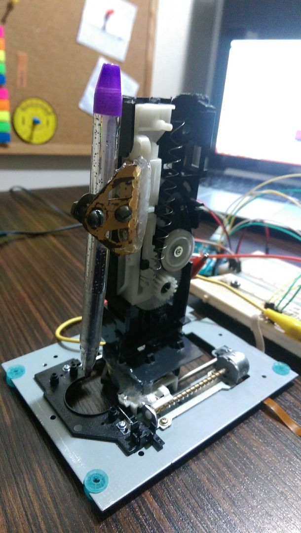

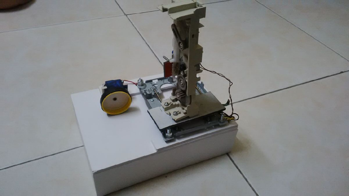

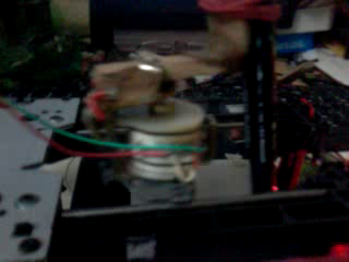

Step 8: The Pen Mechanism.
This piece makes me proud, it's such a piece of engineering made only with my handy dremel and a bench vise.
The gears I took from DVD players and CD readers and the motor from a CD reader. With the dremel I cut the white pieces of acrylic, using super glue to fix them.
When we apply a voltage in the motor, it makes the pen go down, making a dot in the paper, a spring is used to make pen lift and come back to it's position, this way is possible to control the motor with only a transistor instead of a H bridge.
Step 9: All Your Base Are Belong to Us
The base can be made of acrylic, like mine, but you can use wood too.
Before putting the sled on the base, desolder the cable and put a female header to make easy connect it with jumper cables, if you don't have the female header you can solder wire.
In the image you can see that i out some pieces of plastic to make the paper stay in the right place while printing, I made them with rulers.
I used screws to fix the sled structure on the base, this makes easy regulating its height .

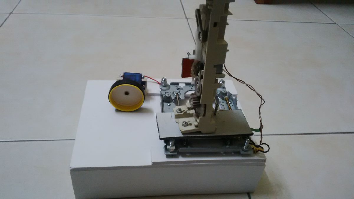

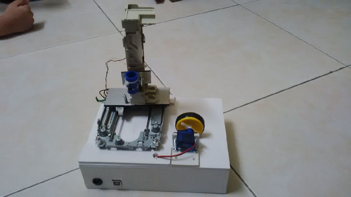

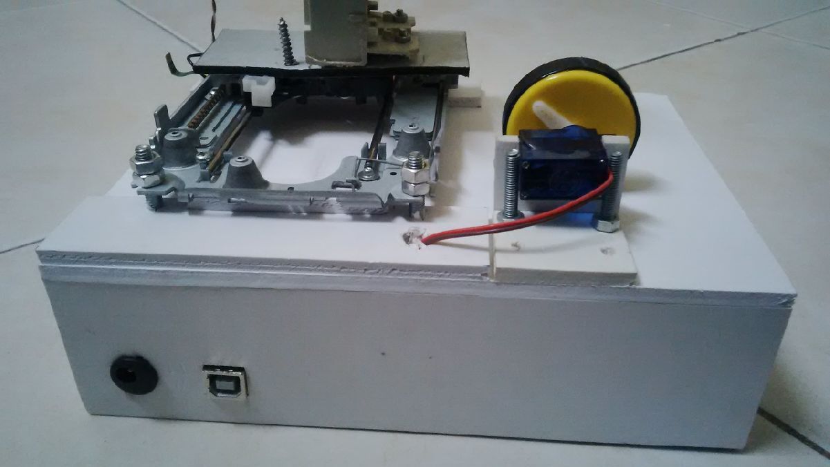

Step 10: Finishing the Mechanics
Ok, let's finish mounting the mechanics.
Put the mechanism for pulling the paper on the base, see how much it is close of it, the wheel must make enough pressure on the paper to don't let it escape, but it can't be too strong, to allowing the paper to slide through the base.
Now you have the mechanics, let's go to electronics and after that to software!

Step 16: Done!
It was a nice and rewarding journey, I learned many things making
this printer, it is a powerful didactic device, let's see what i played with:
The mechanical part is full of physics, the reduction gear is used to offer enough torque to pull the paper and do it slower than the the motor rotation.The spring makes the pen return to its original position, potential energy being nice here.
The electronic part has the Arduino and the components needed to make the motors spin, I learned how to use these stepper motors from old CD drivers using the L293D chip, they are really nice if you want precision.
About programming we have:
- First contact with Processing, a really nice language.
- Image processing and matrices(easy thanks to Processing), used to know if a pixel in a image is black or not.
- Serial communication used to transport the bits from the PC to the Arduino.
And recycling! I love to take apart old electronics and learn about them. You can imagine what kind of cool things that are inside these scraps.

sir i have copied your program but my stepper motor is not working properly ,pls suggest me what to do?

8 years ago on Introduction
It's mine. Thanks Robson Couto. :)
Reply 7 years ago
Are you made it with arduino ??
~thanks in advance.
Reply 7 years ago
You did it!
And I see you made a lot of changes. Great work!

epic job but i need to aks
is it dangerous to "burn" the arduino? i mean i kinda understand wat it means but is it dangerous?
and how to get the pictures it self so the software processing can process their pixels???
Reply 7 years ago
Your arduino won't burn if you feed less than 12V to it, but the motors can stand this much. So I used 7.5 if I am not wrong.
About the images, I used paint to create bitmap monochromes(save as > bitmap...). But remenber you have to resize the picture too.
