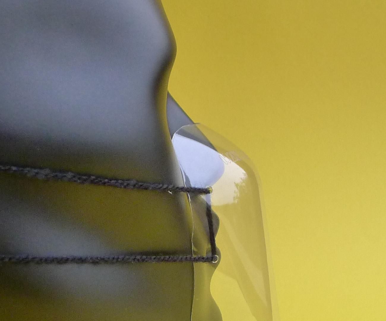

 1. Risk of fire: use low-power LED rope or LED strip to avoid heating the wooden rail. Pay special attention to the accumulation of dust in the rail, which might catch fire. Preferably use LEDs that are covered with a transparent sheet (see picture).

Preferably use a transparent cord for hanging the paintings: it will be practically invisible. The purple rope in the pictures has been chosen only to make it visible.
Step 4: Hook Up a Cord the More Elaborate Way: Noose, Notches and a Crack
The more elaborate way is with small notches, distributed evenly along the wooden rail. An important design element is once more the toothpick (see fourth picture), by which a crack between the wall and the wooden rail is being created. This setup allows to move the location of the paintings without unscrewing the rail. The crack allows to move the rope freely, in order to hook it up on the notches with a noose.
